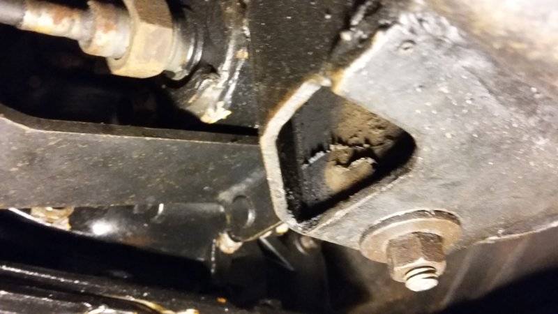

Iv been checking ,checked bolts in tork converter, good ,all belts pully good seem to run to good for miss fire but iv checked,,seems good ,,,transmission mount, I can't see much of it ,but rubber looks kinda split ?? I'm thinking this mite be it ?
What do uall think ?
Put afloor jack under it and see if it separates
Also check motor mounts too
