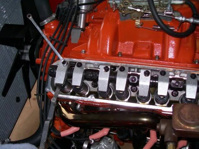

This is the only pic I have of my rocker shafts on my 440 based 493. These are Hughes rocker arms and shafts. The spacers are all from Hughes also. Ron
