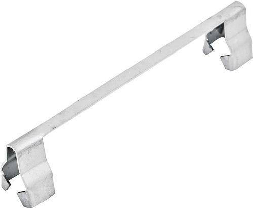

There's a ground strap/clip that goes from the hard fuel line on the chassis to the tank that grounds the sending unit. This is needed because there's a piece of rubber fuel line between the 2 that won't carry the ground. Make sure this is in place
He has already got that strap in place. The needle is moving so the circuit is completed.
