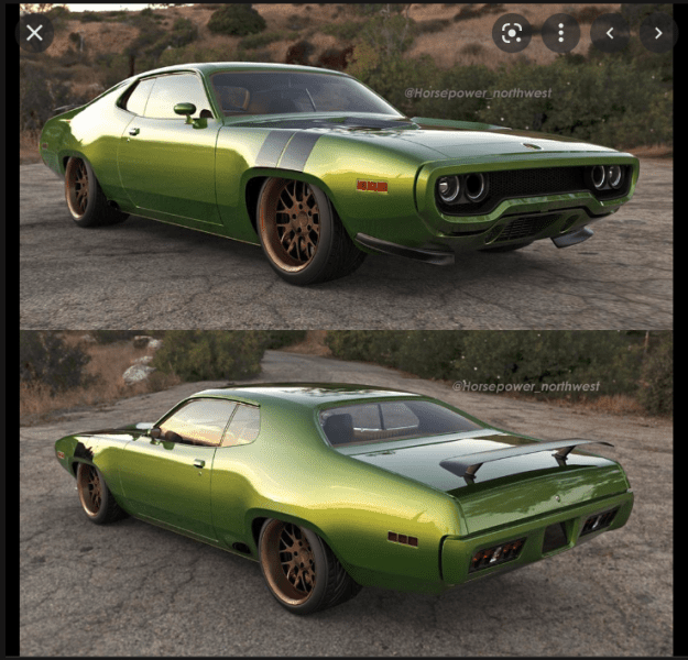

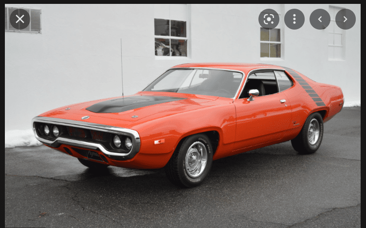

I guess I should have just said a pro touring car that's mainly going to be driven on the street. Maybe some track days here and there. But essentially upgraded suspension, big brakes, wide front and rear tires, and powerful motor.
Stock 1972
Pro Touring 1971
Stock 1972
Pro Touring 1971
How much does the driver/owner of a "Pro Turing Car" benefit annually? Thanks for the pixs.....My '70 GTX is already in that category......but....the last time I went to the grocery and spent $200.00+ for groceries then paid my $7000 property taxes, i showed the clerks pix of my car.....and their comment was: "so what" or "that's nice".......but, I guess its a matter of personal preference and understanding......and wants and need. Enjoy your car.....
