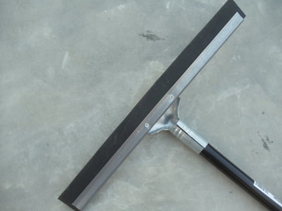

I think the window glass will be prone to scratches if some kind restoration does not take place. I purchased a rubber squeegee today at Home Depot and I was thinking about cutting up the rubber blade into pieces in order to substitute for the missing factory parts.

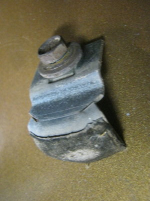

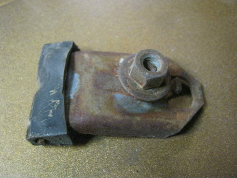

Here's what they look like. There are two per door. This pair was removed from a '73 Charger. One is felt and the other is rubber. I've also seen ones that have a fuzzy whisker on them (not pictured).
I have multiple sets of these in better condition if you want to go with originals.
Those are two diff brackets. The felted one is to keep the glass supported while going up and down, and not just by the catwisker strips. The other one is a bumper stop to the glass plastic stop

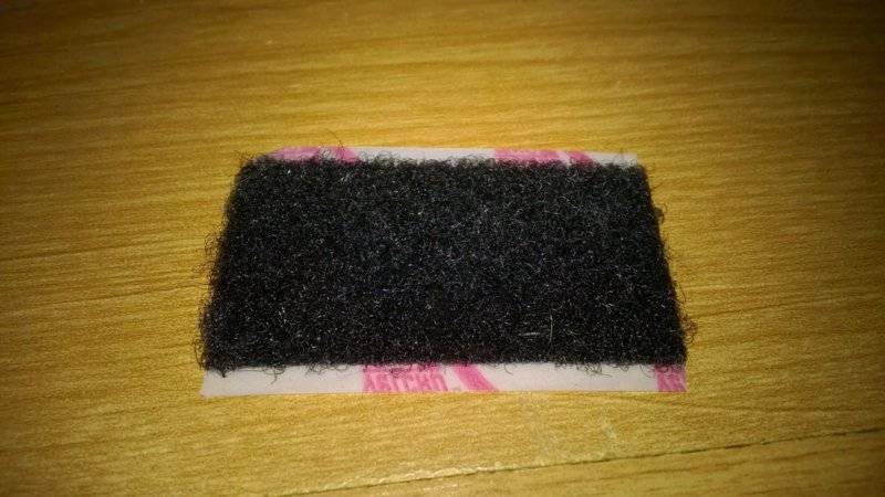

For the felt one, I used 1/2 of a Velcro sticker, not the rough side obviously but the smoother cloth type side. No need to use glue and works fine.
