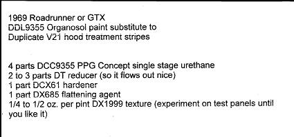

Hello I wanted to share my Organisol ordeal with you. After reading the old application guide for spraying Organisol, I tried the Roger Gibson stuff on a test panel with slow reducer and it didn't look right. (too glossy) The original stuff plus Gibson's is lacquer which really is not very durable. I decided to use acrylic urethane with hardener and texture added. Here is the formula I came up with. Also I have a step by step of the work on photobucket. Each pic has a description if you click on it. http://s657.photobucket.com/user/Jim-2/library/?sort=9&page=1

Thx for the input and pics Jim! I wonder if it makes any difference that I'm painting a fiber glass six pack hood vs. metal. My guy that's doing the work said the paint place says they no longer carry the DCC9355. They recommended this satin finish. Said most of the guys were going to that now that the organisol is no longer being mixed. I'm going to go with his recs and hope it turns out clean and not too shiney.

Hello, I'm in White Bear lake. I'm sure Welle Auto in Columbia Heights on 44th and Central still has DCC9355 or could mix it up. I don't see why fiberglass would make any difference. Mine's a 69 Plymouth Roadrunner B5 blue.

You're right, no DCC9355 anymore but DCC9300 is the same stuff less the added flattening agent. So you would have to add some more of that.
