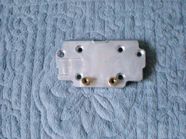

Lew,I have been running QF plates for three years now and no issues at all however I went with the cast plate instead of the billet.They are the same dimensions as the O.E.M. and beside jetting can be made to use adjustable idle feed restrictions,a lot of people aren't even aware that the cast plate even exists.On another note the fellow that sent me the last set of carbs for restoration said it flooded constantly since he rebuilt the carbs and would hardly run,you know what brass floats will do in the end carbs !!
i had to remove metal, the hard way, from the billet plates i have, plus removing the parting line on the nitrophyl floats. a lot of trail and error work. brass floats won't work at all, and i think i had trouble with the white plastics. decided not to use them because i'm not sure how much clearance between the float and plate is needed for smooth hot operation. to me they're just another gadget to re-engineer something that doesn't need to be re-engineered.
Do you have a part number for the cast plates? all I can find on the website are the billet.
