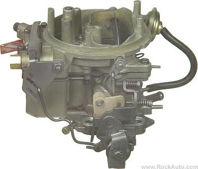

Here's a stock pic. Autoline #C7108
Okay....just shooting from what I can see here which I admit isn't all that great.... The PVC should connect to the 3/8ths nipple that is just below the black hose on the right. The dizzy vacuum should be the smaller (5/16ths?) below that (looking at the picture). In looking at other pictures of this carb, I see there are two nipples on the other side from what we see here so that small nipple in the back may not be right but I can't get a good picture of the pass side of the carb to know what is up with those other two. You will need to see if there is a lot of vacuum on one of those smaller nipple port at a normal idle, that is a manifold port. The MAIN thing you need to be sure is that you don't connect the dizzy vacuum to mainfold vacuum. For example, Edelbrock (and carter) 4 bbls have two nipples on the front of their carb (with the pvc nipple in the middle) and of those two smaller nipples, one port is lower than the other as one is above the throttle plates (dizzy vacuum on emission cars) and one is below the throttle places (manfold vacuum).
I know on the pass side, the 2 top lines go to the charcol canister but idk bought the small one st the bottom. The bottom one on the right on the back idk either. Maybe both are intake/vaccum amp lines?
With the engine running (at idle) and with the nipples blocked off, pull one and see what kind of vacuum there is. You can hook your dizzy up to one that is showing manifold vacuum and see how it works but typically the later emission ladened cars used what was known as timed port vacuum port.
