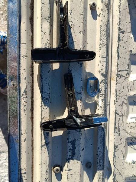

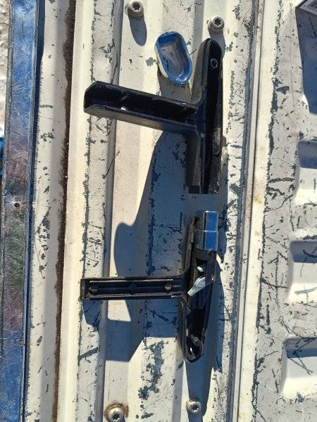

We are getting close to being done with the 71 Charger 500. I went to check to make sure the trans was in N or Park and the thumb button was depressed and wouldn't pop out. I took it apart and I could depress the skinny rod inside the shift lever and change gears but I wondered what was wrong with the handle. Is it missing parts? Any ideas as to why it's not working?
Yes the spring in the shaft is functioning but it's not working at the button level..I wasn't sure if the handle was missing a part. Maybe it just got misaligned.
Looks to me like the button/fulcrum is upside down....
How can it push down on the rod in it's current configuration..
Thanks, I'll try it the other way. I may have just put it together wrong for the picture. It came apart once I took the screw out and the bezel off.
