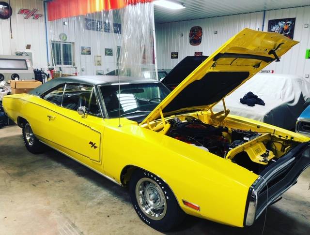

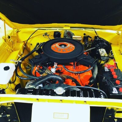

Hi guys, I'm also having a similar issue with my freshly restored 1970 Charger R/T. She fires right up when cold. If you drive it in stop/go traffic for 15 minutes and shut it off, she barely cranks. If you let it sit for 10 minutes she'll fire right up. I noticed the negative battery cable that's grounded to the intake bolt and radiator support gets pretty limp when trying to start it when hot. Battery is a brand new reproduction that measures 12.7V when it's unhooked. 1970 B bodies only had these 2 ground points and none of my other 70's have this problem. I'm open to ideas and thanks in advance. Bill
