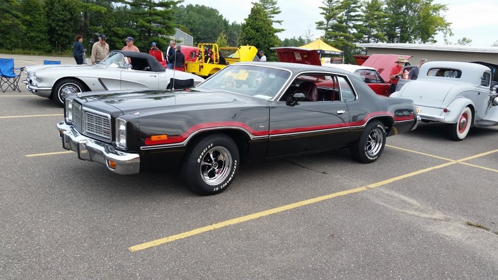

I bought a 77 Monaco 2 years ago with the 360 with a 727 trans. Only 53,000 miles so has been stored a lot . it seems when not used for a while the tranny is very sluggish to engage. After warm up not so bad. Wondering if anyone has any suggestions. If maybe just a new filter and fluid change would be good of if likely something more serious.
