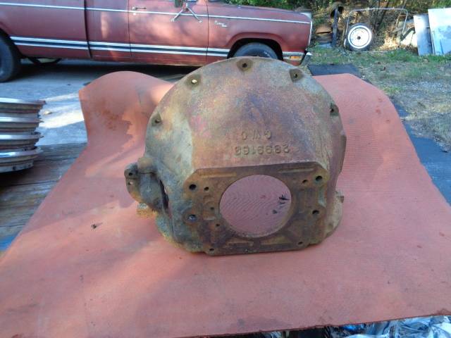

I have a small block bell housing that I took from a 67 A Body 340 4 speed many years ago. But the numbers say it is from a late 60s, early 70s pickup It is cast iron, not aluminum. But i will sell it cheap... say $75 bucks + shipping.

Thanks for the offer. I do appreciate it. The bellhousing in the pic is for a NP435 or similar (think heavy truck granny gear) trans. I am pretty sure it won’t mount to an A833 style.
I'm pretty sure I took it out of a 67 Barracuda with a 4 speed. The car was changed to Automatic at the owners request. But I could be mistaken, as it was probably 35 years ago...
EDIT: I looked up images online, and you are correct. Glad to find out, as I was planning to unknowingly sell it to someone. NOW, I got to try and remember where it came from.... I dont recall ever working on a sm block straight drive pickup....
