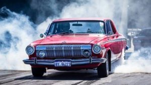

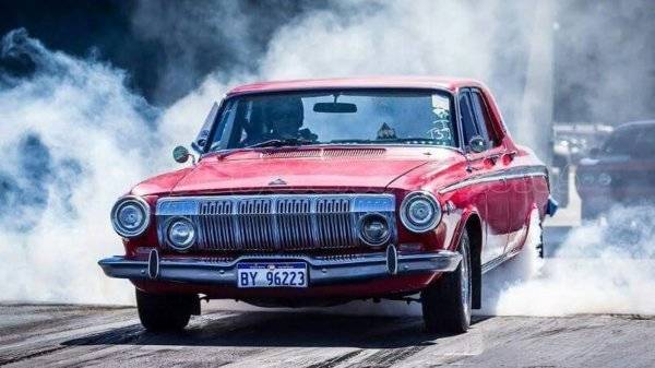

my 360/408 1963 dodge Polara sedan (Phoenix) here in Oz best 12.5 @ 110.
Combo was in a 1970 dart with a 12.01 gives you an idea of performance loss over the two bodies
