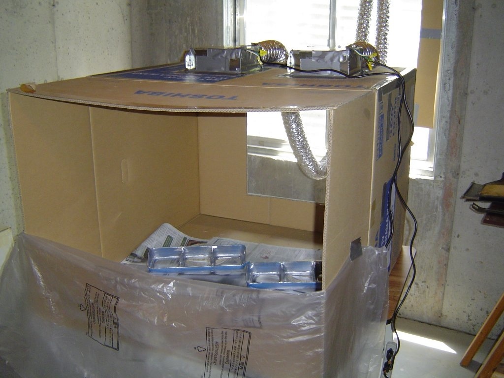

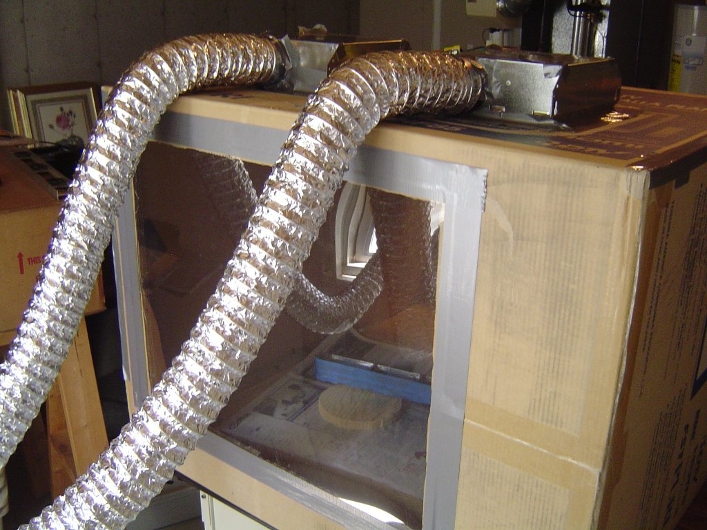

Probably not the safest way, but I converted a large tube tv box several years ago into a small booth. I use two bathroom vent fans that have small filters over the screens inside the booth to keep the paint from going inside the fans and vent pipe and to outside and the piping I can hang out my basement window to vent fumes. I have a plastic sheet on the front so when I am done spraying, it can be pulled up to cover the entire front and suck out the vapors to outdoors.
I put the window in the back to let in more light, but not shown in these pictures it the fluorescent light that is not installed in the top. Its worked great over the years, mostly for rattle can stuff when I was restoring the RR.

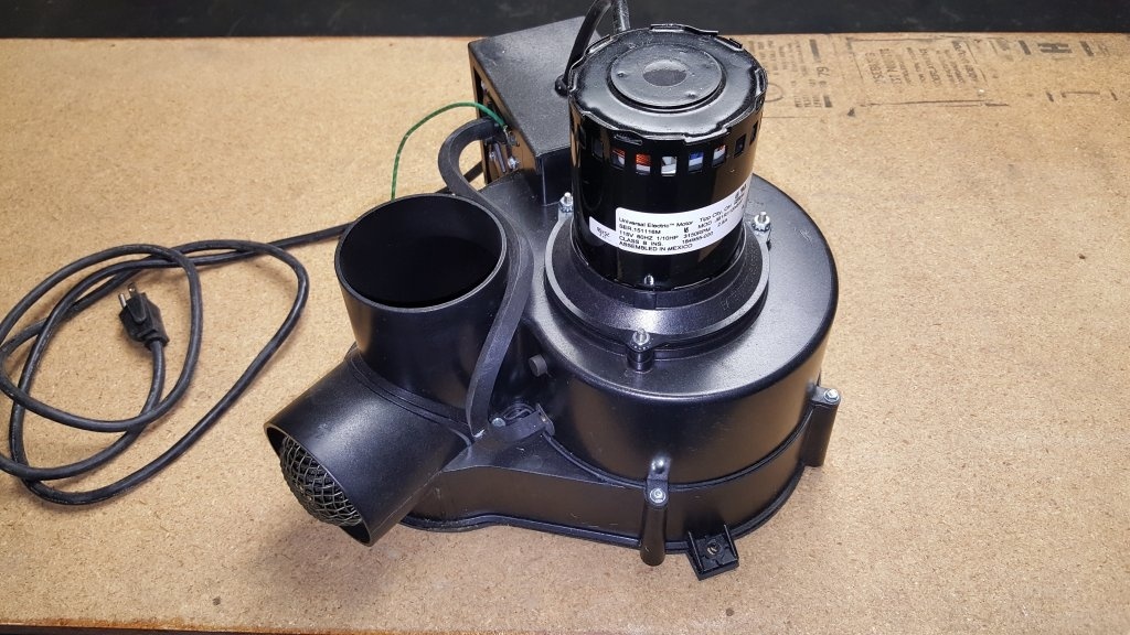

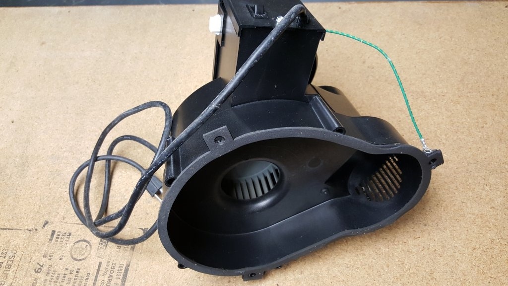

One of these would work for an exhaust fan. It's off of a gas water heater. Just cut the shape out in the top of your booth and hook up a pvc or flex hose to the outside. They are 110 volt. They are expensive new but a appliance junkyard should have one cheap. I grabbed this one off of mine when a basement flood ruined the burner part.
i used an attic fan, painted many parts with a gun, i just turn the fan on before spray, so theres no build up of fumes, same way a friend of mine has done it for 10 plus years, I'm still alive and have most of my hair, (not lost from a static explosion or fire), probably not the safest, but it works. fan costs around $100.00 new, comes with colapsable vent, for outside of building
Some good ideas for sure. I like the water heater draft inducer, and I already have one on my shelf. Not sure if it will produce enough CFM, but I'll check it out.
