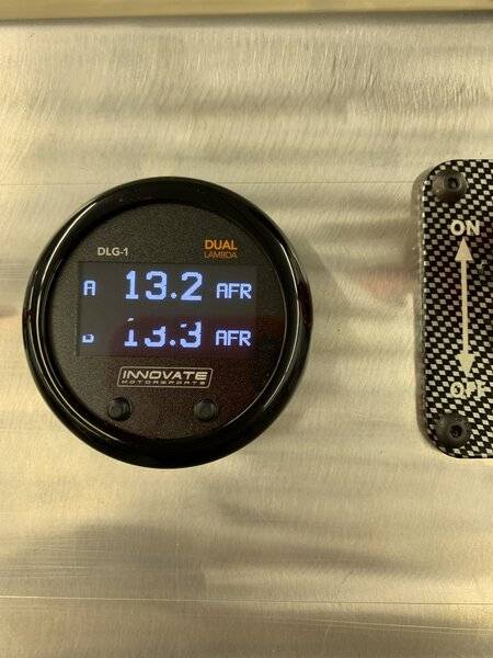

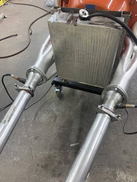

So anybody try a wideband O2 on a crossrammed Hemi yet?

Would you need two sensors and two gauges? One for each bank? Also why is there no vacuum port on the crossram carbs? Thx Scott
I'm using one also on a MW and put it in a header extension and helps with tuning. All things being equal, as carb tuning, both sides should be the same. I use a synchronizer type gauge on the carbs to get them equal.

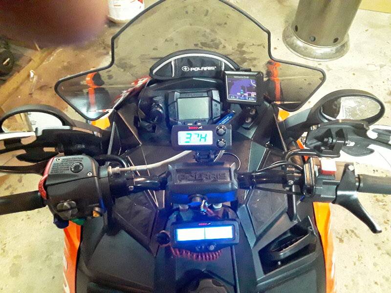

I've been experimenting with Koso gauges on the modded 800. above the bars is afr,below is egt. the screens are normally blue, flash
red if your in the danger zone. much better than digesting numbers at speed!the warning levels are completely adjustable.
the 500ci stroker is getting AFR in the spring, why throw hp and pistons away when the opportunity to actually see what's happening in the cylinders is now a reality!

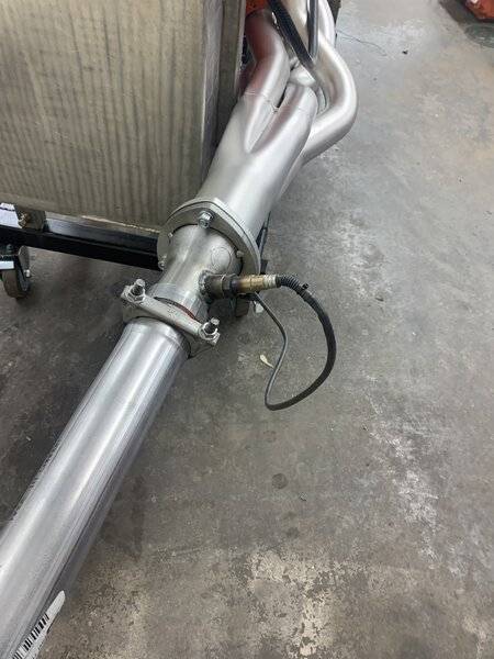

I run an AEM wideband on my 472 cu Hemi with a late Mopar cross ram and the re-issued Holley 770cfm carbs. I drilled my coated TTI passenger header with the car on jackstands. I welded the O2 bung. My thinking was if I need to drill and weld a bung in the other side, I will do so. I haven't had to do so as my tuning the one side got got me there. I also relied heavily on reading my spark plugs. My process took me, on and off, about a year. I took copius notes and read a very good article sent to me by a member here Fran Blacker. He was very helpful. I drilled, pinned and tapped my carbs for adjustability. I'm running a PCV system, Moroso catch can, Mopar Elect. Ign with no vacuum advance. My car is a cruiser and I'm knocking down 13 mpg. These intakes were not made for street manners but they can be made to work.
ooooof looks like its definitely a process. What does drill, pin, and tap the carb for adjustability. I love the look of the xram but they are a bear to live with. Do you have a solid roller cam in it? I thought about EFI BUT have heard nightmares about it. Never seen it done on a crossram either.
It is a process. I like to learn and I don't give up easy. To adjust the various bleeds in the carbs, i.e. idle fuel restrictors IFR, idle air bleeds IAB, power valve channel restrictors PVCR, you measure the factory orifice, drill the orifice, tap for a 6/32 or 10/32 brass insert. This allows you to install threaded "jets" to adjust the air or fuel orifice for tuning. Then you tune for idle, cruise and wide open throttle. I understand why some choose the EFI route. It has been done on Hemis. I prefer port fuel injection vs. TBI. I have an Edelbrock Pro Flo 4 on a stroked 318/390. It runs very good but there too, was a learning curve. Pick your poison, it will cost you time, money or both.
