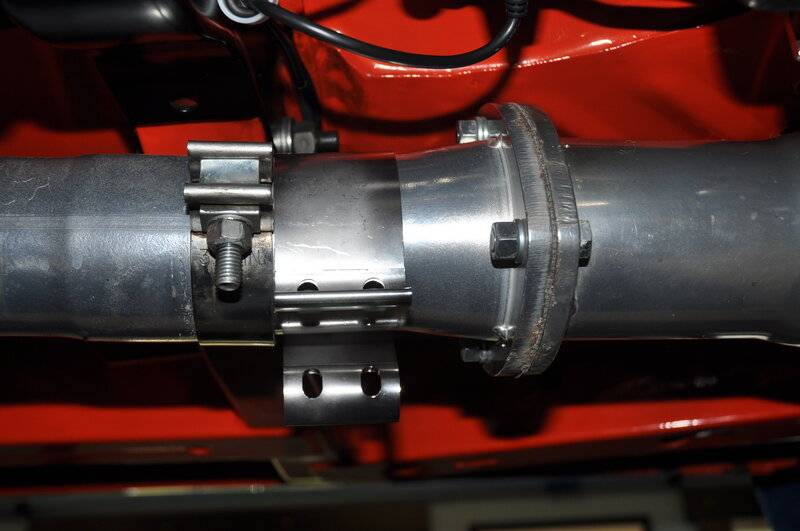

TY sir. Just finding the spot to install the SENSORS now. Does this look like a good spot where the non weld bung is? Behind the header flange and right in front of the exhaust clamp? NOT drilling anything right now just laying it out and planning. Then will get the metering blocks and anything else I will need...jets, etc.
I think that would be ideal, BUT the system manufacturer should have an installation recommendation, so get as close to that as possible.
View attachment 1269724[/QUOTE]
that’s exactly where i installed the bungs on mine
My 2 (L,R) are installed between the header collectors and the Doug's cutouts, so basically where you have indicated.
I was told that open cutouts could affect the readings, but I haven't seen that yet.
I still have to suggest checking the manufacturer's recommended installation point.
Chances are that I will need larger diameter primary tube TTi headers (1⅞" now) for my 572 RB engine, and if the manufacturer of the O2 system says OK, I will get the collectors pre drilled and threaded by TTi as I will also have those ceramic coated and polished like the ones I have now. If they need to go farther back, then that is what I'll do.
