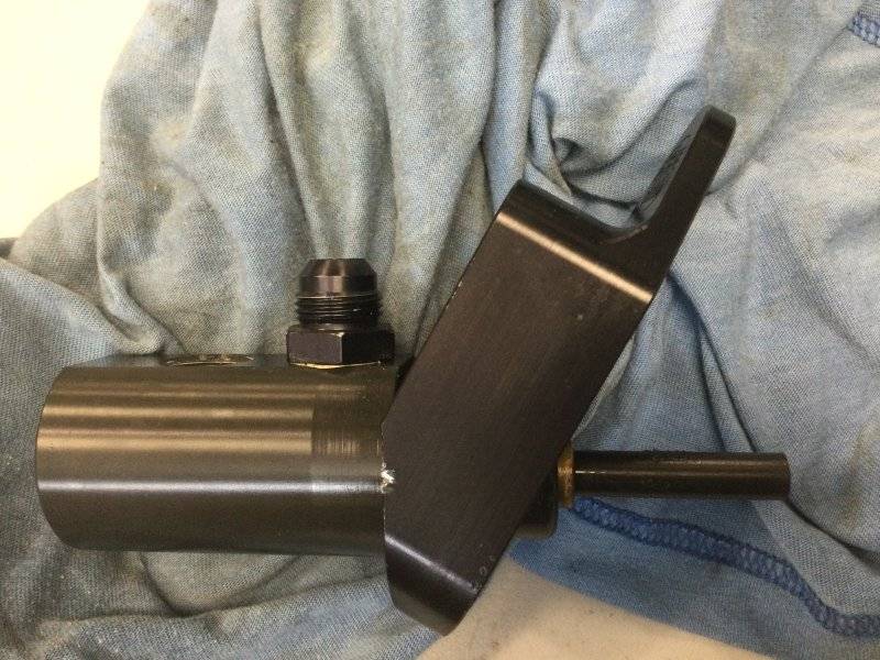

That fuel pump is interesting, what brand? Wonder if it holds the heat causing fuel to boil in low demand times?
Not sure. It is a pump used by Barton years ago. He told me they suck. Just haven’t gotten around to swapping it out but it is time now. Also thinking I may go electric as the manual pump gets heat soaked from the block? I have a brand new Carter here in the box. Just trying to figure how far I wanna go with re plumbing. I may move the regulator and replace all the hard line too. Have had a ton of issues with the car so I may just do that. The hard lines are too close to the exhaust in a few spots and if you change the bends then it is too short.

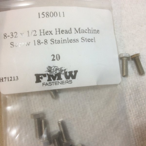

Is it a 8-32 x 3/8" bolt with a 1/4" head? Isn't a wrench ignition wrench set. I have a 1/4"that's 3/64 th thick wrench from a Cox GT 40 slot car kit for adjusting mine.
5/16 bolt head 10/32 thread. the custom wrench shown is a craftsman 9/32 opened up to 5/16. works great with the jaw straight up turning the screw.
They must've changed the thread, assuming you have 4235/6 carbs? Mine are 3116's forget exact month but think Nov. 64 8/32. Thanks

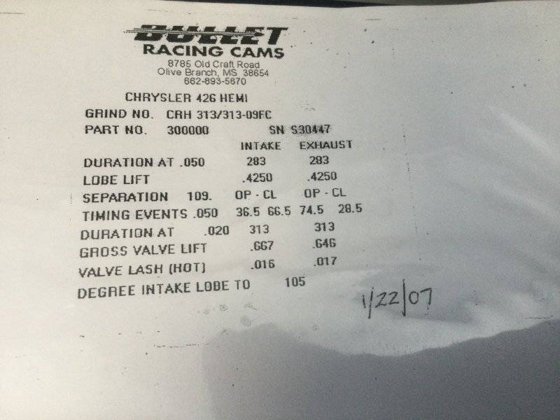

Whelp, a small update. Found the hard fuel line touching the exhaust. (NOT MY WORK). The fuel filter is just too close to the muffler. Knew it was like that. I also had a fuel pump by on the Racepumps.com on the engine. Barton told me to remove them as they suck. So putting on a new Carter and replumbing the the system. While doing this I removed the fuel pump shaft and noticed it looked like a shaft for a regular solid camshaft instead of a roller cam. I for some reason thought my engine had a roller cam. Looked in my folder I got with the car and came across the bullet cam card. Looked it up and it seems to be a regular flat tappet. Will call Monday to confirm but if true now I know why this thing is such a nasty bastard. I maybe changing cams in the off season as my belief is a roller is more streetable with the same specs…correct? Pic of cam card also and my Hemi is a 472 not big CID Hemis like many of you run. Thanks for any insight….Scott
thats alot of duration @.050 for a street motor solid flat tappet, my roller comes in at 272-276 @.050, .675 lift and is borderline too much for street use but my springs r spec'ed at 290 lbs closed and 550 open so with my isky redzone lifters its a matched set...But i know i would be better off with CC .650 roller, 260-268 @.050 which i had in my last motor. good street manners, adequate vacuum, and made good power. but its so close now unlike yours it would be a big PITA to change it for so little gain/loss.....my 2 cents.
Yea, thinking I will pull mine and also change head gaskets too as they seem to be seeping oil a bit. Drive me nuts. This engine is around 16 years old and doubt it has 1000 miles on it.
That’s a solid flat tappet. My buddy ran the same cam in his 472 (Barton built). His was around 12.1, ran super strong. Ran 10.40’s through tail pipes in a full weight 68 B body. He drove the piss out of that engine on the street for years.
Yea, it is a stout cam but a tad much for me. Just deciding what to do at this time. I want less duration than 283 at .050. and something that will idle closer to 1000 rpm instead of 1200-1400 rpm. This will give me an excuse to take care of other things all at once. The head gaskets seep oil so it will all get done at once...along with anything else I can think of. Not sure if I want to go roller or just go with another flat tappet.

Finally put 8/32 X 3/8" BOLT to adjust the secondaries. Thanks Stage3 . Have a restricter with a .030 hole in metering block IFR, completely closed primary throttle plates. Set the adjusting to just touching but not opening primary plates. Adjusted secondary throttle plates open a crack.Started the Hemi up it sounded really different. After running only a minute or less the thing would idle. After it warmed up I closed the secondaries to lower the idle some. Throttle response was crisp. Picture 1 (CROPPED OUT ARROW ON LOWER HOLE) is where I tap for a brass set screw with a .030 hole on both sides on both carbs. 2nd picture of bolt for secondary adjustments. Had to grind hex thinner so secondaries could be closed Note 2 bolts on right one is cut. 3rd is bolt installed red arrow. My carbs are 3116 Oct 64 so the 8/32 bolt maybe different on later carbs.
u dont want them completely closed,,,u want them so as looking from under neath the transition slot is squared by adjusting the primary throttle plates accordingly...That way u can tune the idle air screws more accurately. doing it like that mine idles great and have Instance throttle response..
Even with the plates closed the trans slot is rectangular. This was a starting point, it was a tremendous change from before. I was really surprised and hadn't planned for doing anything but getting it to idle which it did. Just closed the secondary some with an 8th turn on that bolt. Thanks for the advice.
