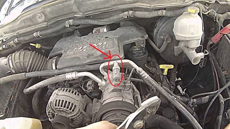

I instead contact the local Chevy/Dodge/Jeep/Cuisinart/Electrolux new car dealer up on the 4 lane, since I've had vehicles over there before (recalls mostly) about an a/c pressure transducer switch I managed to break by accident back when I was changing plugs on the hemi Ram a while back.
(You gotta pretty much climb up in there to do those plugs. PITA.)
I send them an email with an actual picture of the switch in question to boot, asking for a proper quote to replace it.
What I got back was some long-winded story about how that switch was "obsolete" and that it would require the updated switch @ $150 PLUS an adapter harness to make the updated switch work on my obsolete truck ($50) PLUS they were going to have to totally evacuate and then recharge the R-134A freon in the system (2.5 hours!).
Total estimate was $440.00.

I did a little homework.Turns out, that "obsolete" switch is available at EVERY parts store known to man - for $50.00.
No updated yida or new harness yada - and no need to discharge or recharge anything.
Unscrew broken one, screw on new one, plug it up, bask in frigid Chrysler Airtemp air conditioning. :)
I did so, right there in the AutoZone parking lot today. Took like 5 minutes.

The offending part:
(Not my actual truck - I keep mine a tad tidier)

What year is your truck and what were the symptoms that led you to replacing the switch. I have a 03 5.7
Mine is a 2004. Had her since new:
Built at the old Fenton, MO (St Louis) plant. She's been a good one.
Oh, symptoms? I broke the damn thing when I was rolling around under the hood changing out $@$#$% spark plugs on the hemi.
Without that switch (I've seen it called both the "high pressure switch" and the "transductor"), your compressor clutch won't engage
and the indicator light on the a/c button in the instrument panel doesn't light up.

I can't understand how the switch (in the picture) could be changed WITHOUT loosing refrigerant? Any answers?
Mike
