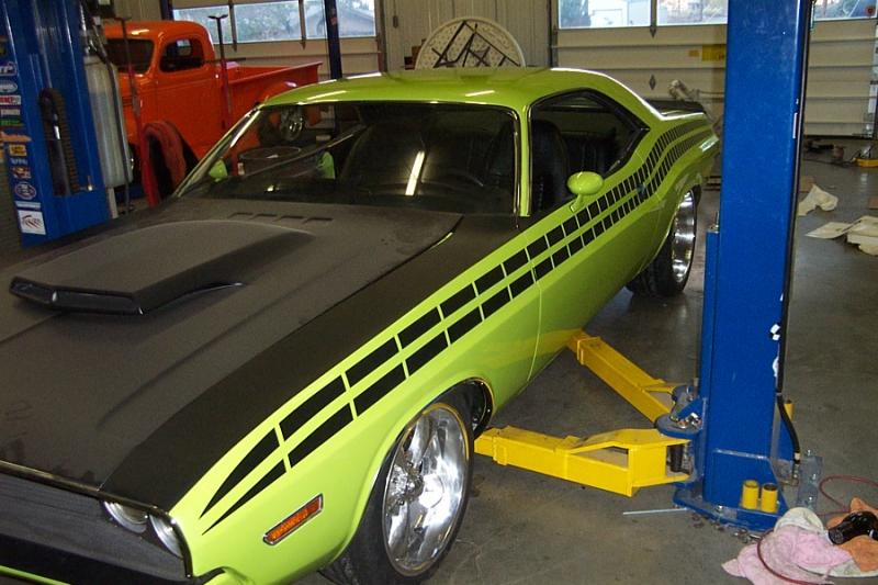

Take pictures for us.

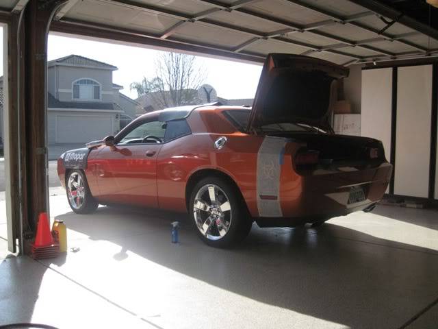

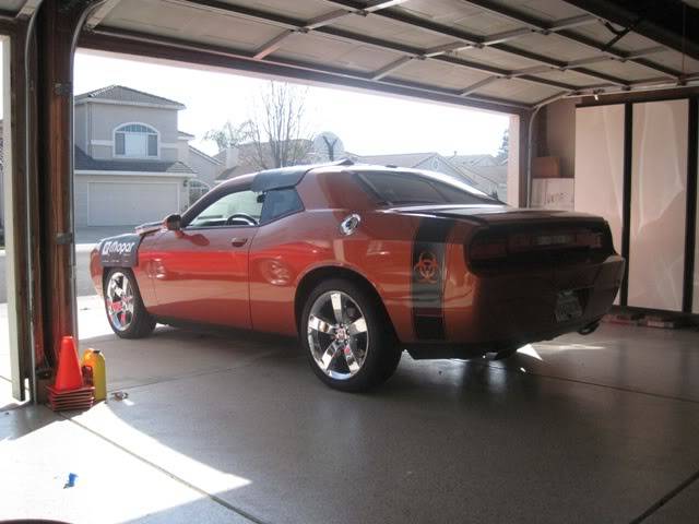

Here are the stripes I put on my Challenger

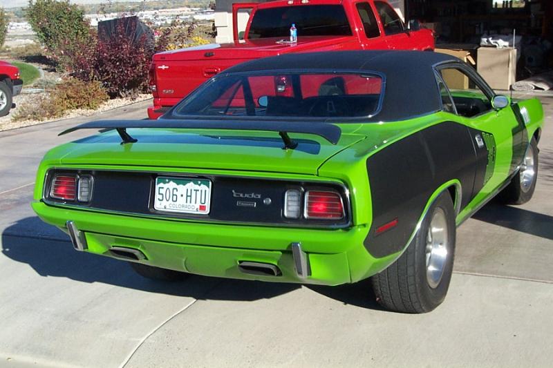

Good advise. I've done alot of decals and have used dish soap, Windex and the jel that you can get from the decal people. The jel is the best and all I'll use when doing 71 Cuda billboards. I recommend the jel or dish soap w/ water if this is your 1st time.

SWEET! wow... great colors, pop out get ya colors.. :love2:
