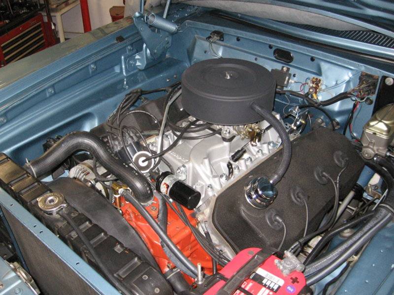

I've had my 65 Hemi at home just about 2 years now. Because it was a EX-Race car some changes need to be made to make it more streetable. The cross ram ran great but I wasn't able to run air filters with the hood closed. It's too dusty in the desert. Didn't want to go with a 5'' hood scoop, wanted to stick to the factory 65 A-990 scoop. It don't have the looks but the car still runs great. Next is running vacuum advance, changing the manual valve body to a stock one and kick down. Last but not least swapping the 4.10's to 3.23's.This way I might be able to drive it without stopping at every gas station along with tires lasting longer than a few weeks. The air filter housing is from a Slant Six. I hope to score a single Max Wedge air filter housing in the future.

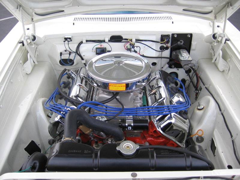

Yeah, The Max Wedge air cleaner housing will look much better. Here is one in Chrome.

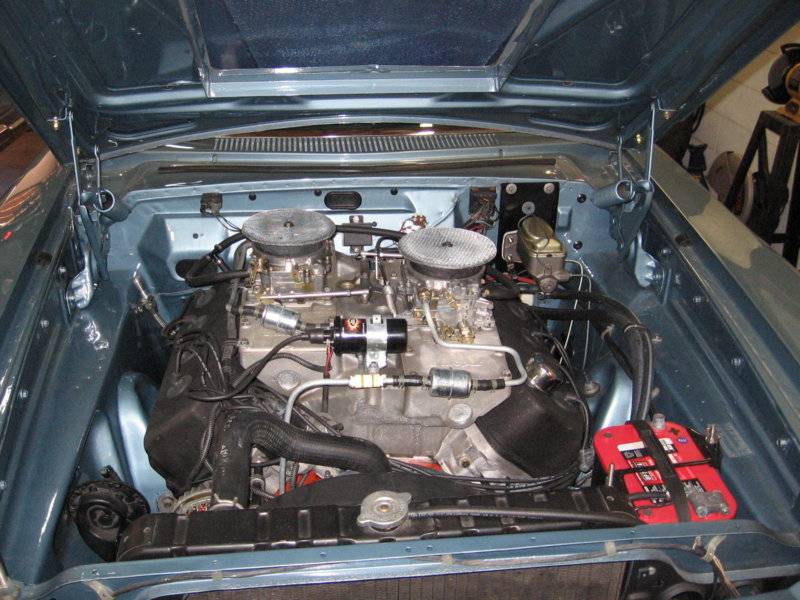

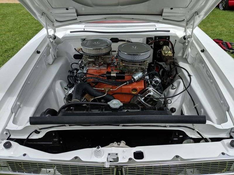

Darter, odd that you cannot run air cleaners under the scoop. I think we have similar setups and my air cleaners fit under then scoop.
Looks like you have the MP cross ram. Maybe it is taller than my repop crossram.
I know what you mean about the loud pedal :)
MP cross ram is 2'' taller + Indy Heads add about another 3/4 to 1 ''. Maybe some day I'll get a intake like yours. The single 4 bbl gives me about 1 1/2'' clearance using a 2'' tall filter.
