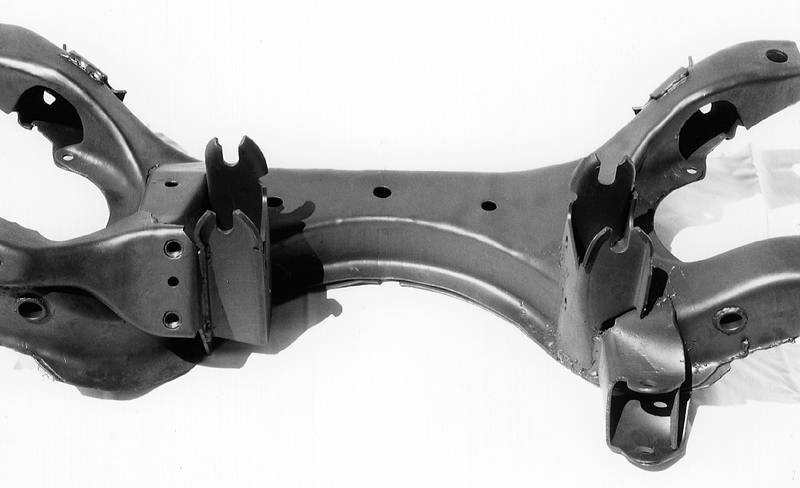

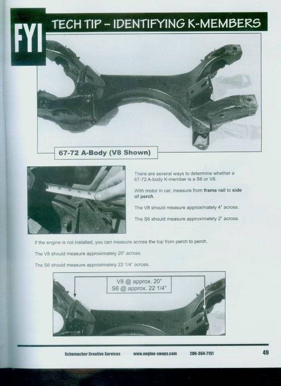

Shouldn't it be addressed that for 66-72, there are no bb or sb k members? They only have a v8 k member that works for both...

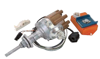

b. ELONGATE YOUR IGNITION COIL WIRE DUE TO DISTRIBUTOR LOCATED IN FRONT OF ENGINE, NOT NEXT TO FIREWALL AS IN SMALL BLOCK CARS (if you are using points, disregard)
images
c. RECOMMEND UPGRADING TO ELECTRONIC IGNITION

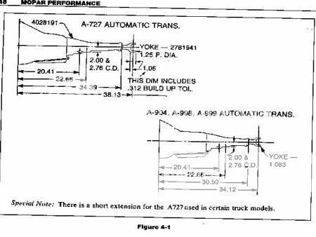

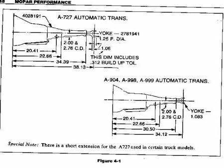

d. SHORTEN DRIVESHAFT 4 1/8” TO ACCOMMODATE FOR LONGER 727 TRANSMISSION

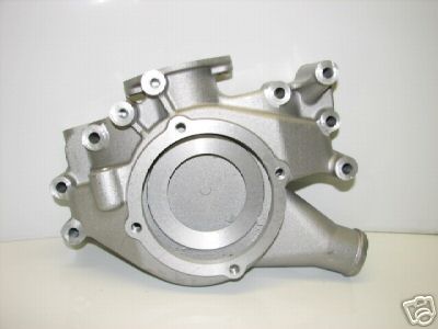

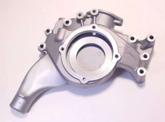

h. INSURE WATER PUMP HOUSING INLET AND OUTLET’S MATCH RADIATOR INLET/OUTLET

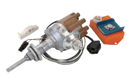

d. ELONGATE IGNITION COIL WIRE AS THE DISTRIBUTOR IS LOCATED IN THE FRONT ON BB ENGINES, NOT NEXT TO THE FIREWALL AS IN SB APPLICATIONS (if you are using points, disregard)

i. SHORTEN DRIVESHAFT 4 1/8” TO ACCOMMODATE FOR LONGER 727 TRANSMISSION

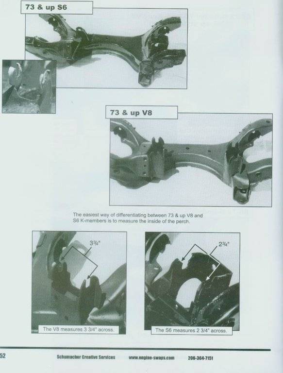

K-MEMBER IDENTIFICATION
68-72
73 +
