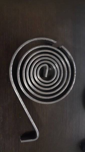

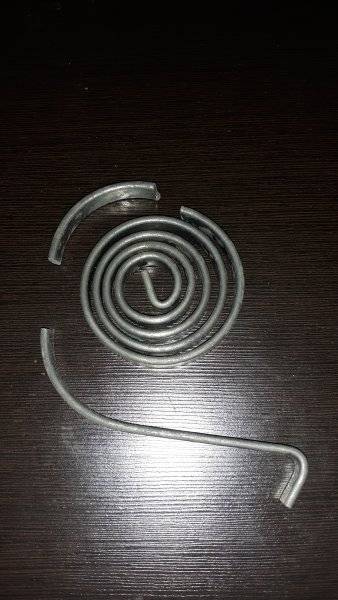

Those springs are pretty heavy, i didn't think they could break.. i'm lucky that most of my car is in good shape, just sitting for decades dried stuff up
That's what I figured also and I think I even saw another thread where a member had soaked theirs but those things have a lot of pressure on them and they gave out. They didn't even look that bad either.

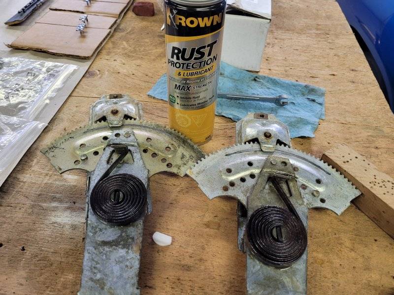

Any kind of spring and any sort of acid (which evaporust is) do not go well together. The springs may have been weak but the evaporust put the nail in the coffin. You can put a spring and a piece of the same thickness wire in an acid wash and the spring will disappear - but not the wire. Its got something to do with the heat treat process I believe.

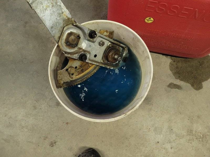

I used diesel on a pair of 80 year
old regulators from a Plymouth pickup.
It worked really well in getting the
enclosed crank gears clean as diesel
seems to suspend the dirt and sand.
I let them soak for three days.

As I said back on page 1, where the usual suspect Red X'd me... 3 minute soak in AV gas, a quick brush and all the old goo slides right off..

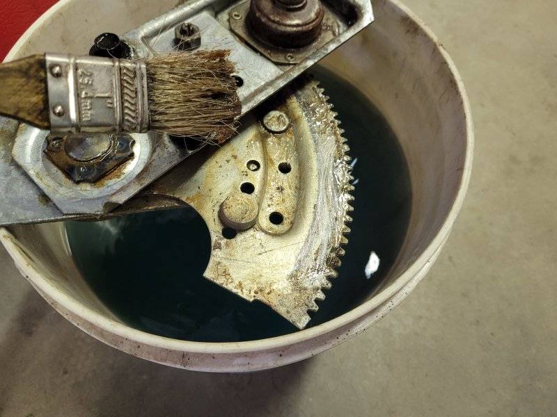

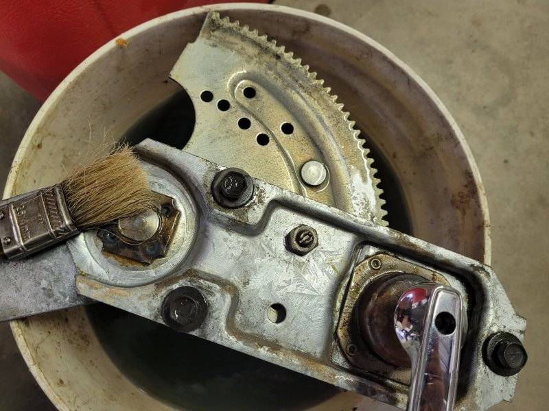

Quick update... the purple power stuff from Walmart was like $6 for like 2.5 gallons.. or something super cheap like that.. i tossed the regulators in a tub full of it for like 10 days (got lazy) and they came out looking like new. metal i even nice and bright again.. :)

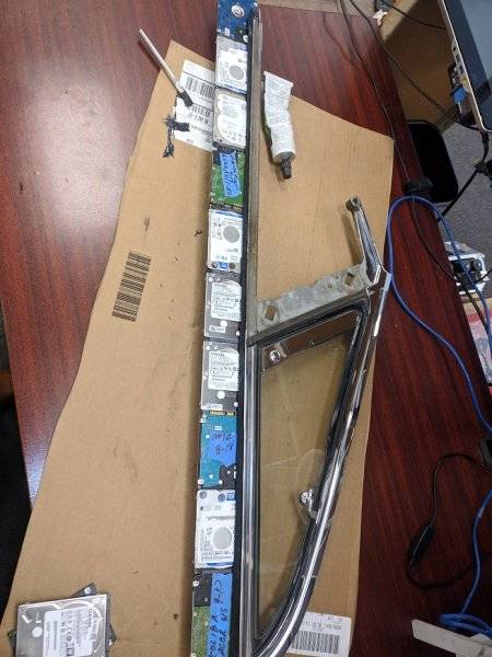

Got my rear channels all cleaned and new felt.. gotta do the long channel that runs down the vent window next.. that one looks a bit harder
Evaporust is not an acid you dimwit!
Throw some galvanized in Evaporust and leave it there for too long, see what you get back. The regulator arms, at least the ones I just cleaned are cold galvanized.
Figured i would mention that if you don't have a piece of wood to hold it in while drying... a few spare hard drives fit perfectly.

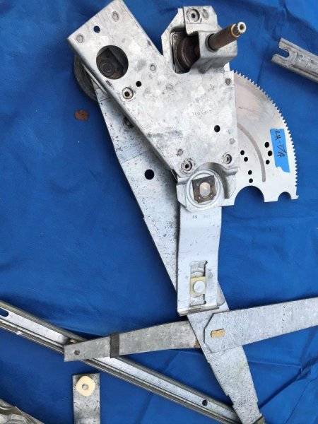

So.. got my front window regulators out last night and after sitting for almost 50 years the grease has all turned almost rock hard, i could barely move the windows to get them out, Can you guys recommend what i could soak these in to loosen up/remove that old hard grease? No cleaning tank.. will get a tub and just let them sit for a week or so.. Was just thinking of using Gas or mineral spirits unless someone has a better way?

The spacer/washer for the regulators ar leather. After 50
P.S. the window channels had like a felt in them for the glass to slide on.. mine is all pretty much shot or gone.. Anyone know the exact name i should search for if it's even available?
the regulator track washers are leather. Hard to find. If you want you can make them. Sen me a message i can give you the measurement.
Yup, i ended up making them out of leather :) all set thanks much
