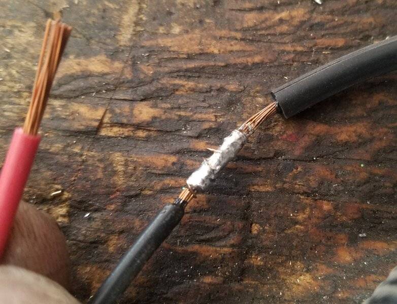

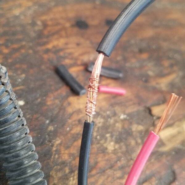

Stab wires together and wrap with a strand of wire to make the physical connection tight. Just learned this one.

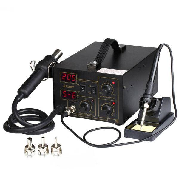

No, a hot air soldering station for electronics. The surface mount components were so small, that is the easiest way to do it. Average components I worked with were 0603, 0402, and 0201 which is a designation for the size of the component, (0.063"x0.031", 0.039"x0.020", and 0.024"x0.012" respectively. They used just air I think for the BGA machine when I worked at Nokia. They had a 80% fail rate for connection, and our line reworker could do it better (90+%) and a hell of a lot quicker. They didn't like that and wouldn't authorize the reworker to do it for us so it had to go to BGA to not work when it came back over a week later. If we just DOA'd the phone and replaced it, it was faster.
Nice soldering station.
It most definitely was. When I went there (Skycross), they used two Weller pencil tip irons like chopsticks. I said I don't do Chineese, so if you want a pro job, get me this, I had it in about a week... :thumbsup:

In post #9 above I would use a lineman's splice or a Western Union splice and then solder them to join the two wires together. It is much stronger.
