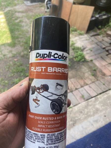

Clean it down to bare metal like mentioned above. Then I would apply this stuff. Dries like paint then install insulation.
