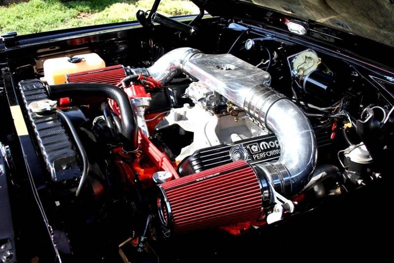

I don't know what set up you have with the hood and your thoughts on originality, but I've converted my twin hood scoops from fake blanked off scoops, to functioning. They aren't connected to the carb, so no "ram air" type effect, but they let cooler air in during driving and then hot air out when stopped. I cut a hole under each with a holesaw, probably 3" diameter.

66....that is exactly what my restoration guy said to do. I remember looking at the scoops when I first got the car and wondered why they were not functional. I see them feeding cool air into the compartment which would benefit the temp of air being sucked in through the intake filter, but I don't know if it will expel enough to remedy the heat soak when stopped. It should help to take away some of the temp created when running, thereby reducing the source of the heat. You are right, no simple fix. A little of this and a little of that. I do like the elec fan controller mentioned by Yatzee. Any thoughts on that? I insulated the filter and line. Just one of the "little of this" to stop the boiling.

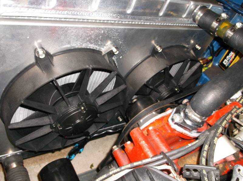

I have 2 electric fans that run off an adjustable Derale controller. I spliced in a manual run through 2 separate switches so I can switch on one or both fans at will. Had it that way for many years. I especially like to run the drivers side when fueling up with engine off to help cool the starter, which used to bind from header heat. I also wrapped my headers years ago. Much better now.
Multimopes, what make and size of fan do you run and for what size radiator? Do you run the fans when cruising? At what speed would you turn them off? Any idea of battery drain and max number of minutes before enough is too much on the battery?
My fans are 11". Not sure of CFM as I am at work currently. My battery is an Optima red which is trunk mounted and is 7 years old. I run a 95 amp alternator. I have a 73 Satty RR clone and there are access panels at each shock tower that I used to remove to help dissipate heat. I also has removed the rear hood to cowl seal to let the heat out the back of the hood while driving or stopped. For some folks this would also let that heat enter the car via the heater box, which I don't have so I blocked off that opening in the passenger side above the kick panel. I will attach a picture of my fans which as I said run automatically or by my manual switches. I also installed little fan run lights under the dash so I know if the fans are on when running down the road. Because of my headers and 3" exhaust I can't hear the fans when tooling down the road.
