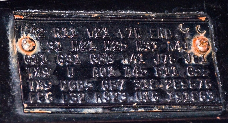

Post a picture of the fender tag.

The likelihood of a 1970 radiator in a 1971 model car would be high IF the car was an early production model, as in one of the first ones actually built - to use up any parts from the previous year. However, after seeing the Fender Tag picture, I suspect this is a case of just being a swap-out for a better condition radiator that fitted as a direct replacement.
Don't see 26 inch radiator on the fender tag. I have a real rt 69 charger 440 car with auto that has 22 inch radiator
The swap is what I was hoping, it was just the size thing that was throwing me off, since it was unlikely that they changed the support also. There were several detail items like this that were off and I was feeling a little uneasy. I guess I was wrong about the 440 HP/26 radiator and it was just a coincidence with all HP cars I had owned and studied in the past.

Well I think that puts the radiator question to rest. If you don't mind I would like to ask another question. If you look at the fender tag in the bottom left-hand corner there is V code. V86? The V88? None of those codes makes sense. The car has what I believe to be an inaccurate v8w code stripe going from the hood center wrapping around the front fender since I don't see that on the tag but as you can see it has a V21 code. I believe V21 + V8W was not possible.
You mean, E86 ? That's the engine code for 440 4bbl.
