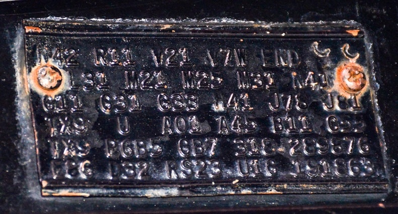

Something not right about this 1971 GTX?
You mean, E86 ? That's the engine code for 440 4bbl.
Of course it is, where else would they put the engine code - don't I feel like an idiot LOL got distracted trying to figure out this stupid striping package on this car since they have it all messed up. Thanks!
volo ? have been watching it for months but they won't budge on the price
decoding from stock mopar
Code Description
E86 440-4 Barrel High Preformance
D32 H-D A-727 TorqueFlite Trans / Some Years A-998
RS23
R = Plymouth GTX
S = Special
23 = 2 Door Hardtop
U1G
U = 440 370HP 1-4BBL 8 CYL
1 = 1971
G = St. Louis, MO, USA
191863 Sequence Number '191863'
TX9
Paint Code: Black / Black Velvet
P6B5
Trim Grade/Style/Color
P = Premium
6 = Vinyl Bucket Seats
B5 = Medium Blue
GB7 Upper Door Frame: Dark Blue Metallic
318 Date Built: 3 / 18 / 1971
289876 Order Number: 289876
TX9 Roof Type OR Color: Black / Black Velvet
U Built to Specifications for USA Order
AO1 light group
A45 Spoiler Package - Front & Rear
B11 Standard Duty Front Disc Brakes
C55 Bucket Seats
G11 Tinted Glass All
G31 Right Hand Outside Mirror - Manual / Chrome
G33 Left Hand Outside Mirror - Manual / Chrome
H41 Heated w/ Upper Vent
J78 240km Speedometer
J81 Rear Spoiler - Wing Type 70-2
L31 Hood / Fender Mount Turn Signal
M21 Roof Drip Rail Moldings
M25 Wide Sill Molding
M31 Belt & Hood Molding
N41 Duel Exhaust w/o Tips
N42 Chrome Duel Exhaust Tips
R11 Music Master Radio AM
V21 Performance Hood Treatment
V7W Accent Stripes - White
END End of Codes
so I've seen j78 be front speaker and 240 km speedo and now spoiler ,hmm does anybody know which it is ? why would they have spoiler package A 45 and then call out front spoiler separate
I can't speak for other years but for 71, J78 designates front spoiler to go with J81 rear spoiler. Yes, in 71, St. Louis coded the spoiler package and the individual spoilers.

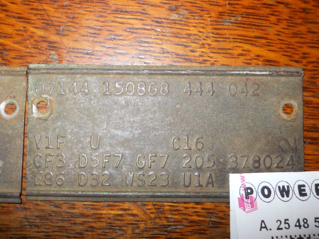

Tag on charger I have for sale 22 inch radiator as well as my Roadrunner. My 318 Satellite with AC has a 26"
Mine is an A/C car with a 26" radiator that car of yours has a few nice options. Front and rear spoiler package and turn signal indicators. Formal Black with a B5 blue interior and B7 upper door frame color. That must be sweet looking. Do you have a picture of it! And the U is a built to USA spec car. Someone ordered it special just like mine.
