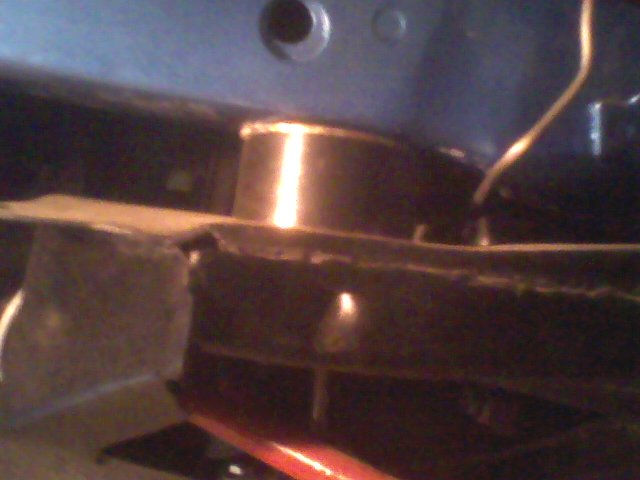

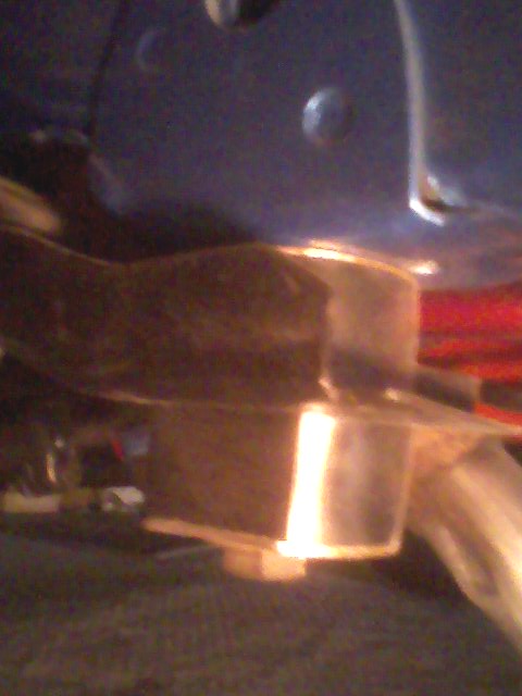

You've pretty much answered all your own questions. The k frame is rusted out and all the bushings are bad. Since the k frame supports the entire front suspension, any wear on the bushings where it attaches to the body will result in skewed alignment settings. Can you post a pic of the rusted out area?
yep , they like to rust between the bushings
this is what they should look like new

I would slap aluminum bushings in there so quick it would make your head swim.
