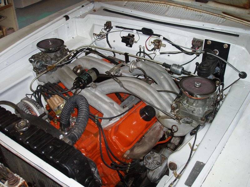

Here is my other '63 with the Long Ram manifolds ... Considerable off the line torque!
both photos of the long rams are not 63 or 64 long rams.
Hi Not quite sure what you are getting at, The Long Ram manifolds were a "C" body item , I'm sure anyone who knows anything about Chrysler performance is aware of that. The manifolds on my car (second photo) originated from a 1960 "F". I obtained them from a '60 that was being parted out as it was far too rusty to save!
I thought it would be fun to install them on one of my '63's and see how well they worked!
The engine is a 440 backed by a '63 heavy duty pushbutton Torque flite that I built. The Long ram manifolds are bottom end to midrange and a bit manifolds , great fun coming out of the hole! I have never ever mentioned the word "factory" when it comes to this installation, which would make absolutely no sense at all as it's not that kind of car...I saved it from a wrecking yard! In the attached photo to this posting you can see the fender well modification I had to make to get the manifolds to fit, I tried a regular cross ram for the photo (those are going on my Son's '64) just to show what those would look like. To use those on my car I'd have to put together a little more engine!
What l think he’s referring to is that 63/64 Chrysler intakes are different. They referred to as short rams. Here’s a pic of short rams. Note the smooth top of intake. I believe they are also shorter in length.
shorter only on the inside 15" to 30" on the 60-61 rams. 63-64 made more power in the upper rpms.
Hi
Thanks for the photo reference Spare Parts! I have never seen the Long/short ram manifolds in person! But frankly throughout this thread the difference between the short or long ram tubes never even occurred to me, as the modification required to install either one in a "B" body would be the same. Take Care
in 1962 the 63-64 rams were an option over the inline 2x4. the 63-64 rams made more peak hp at a higher rpm but less torque than the 60-61 rams
