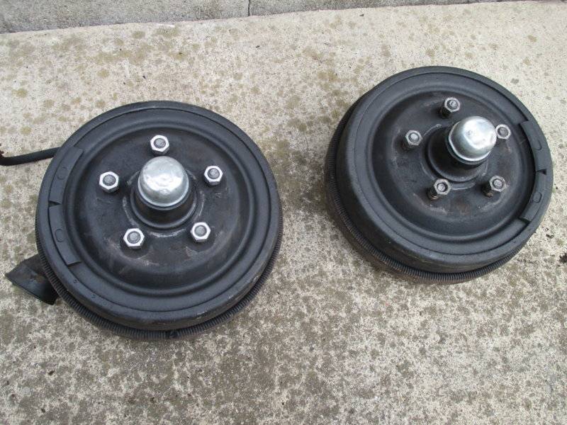

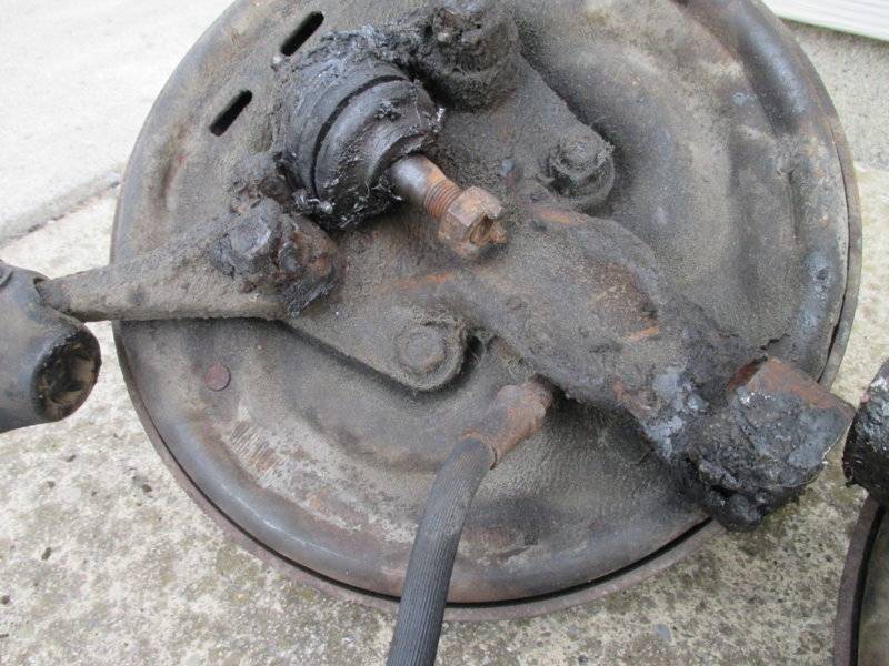

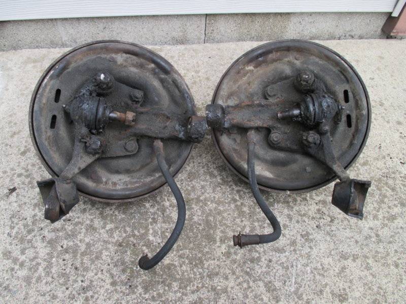

I have 2 complete front drum assemblies, including the spindles, with ball joints, that were working perfectly when I dis-assembled my '63 330. I'm changing to a front disc set up, so I will probably let them go when I get mine back together. I'm just waiting 'til the change-over is complete, in case it doesn't work out...

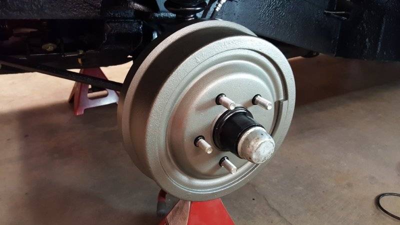

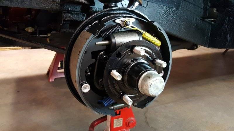

Thought you were talking about the front. I used Dr Diff for the newer style flanged axels and parts needed. Then used the 1970 E Body Brake Drums. That's in my build thread also.
https://www.forbbodiesonly.com/moparforum/threads/taking-up-new-residence.114133/page-11

Then the more expensive way is like I posted with the newer axels from Dr. Diff. You'll need the newer style backing plates, shoes and hardware and drums. 1970 E body parts is what I used. I believe I had around $300 total in the conversion.
