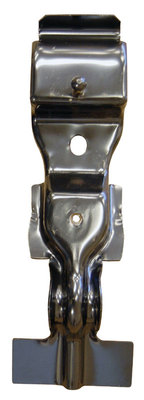

7.75-14 is what the car was made with. That’s a narrow tire. A wider tire will raise the trunk board.
I took some 2x6 wood and constructed a box, that not only holds board and the larger spare. Later model B bodies the spare mounted at an angle towards the back seat. The parts are repoed. Get the anchor for the newer model, and weld or bolt it to the panel that covers the shock cross member. The only other part you would need is the bolt that's used on the later model. If you don't care about the original Mopar look, fabricate the bracket.
