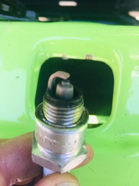

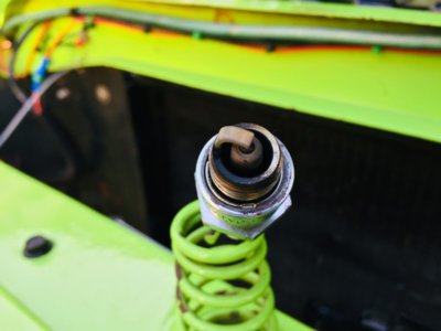

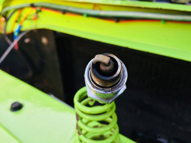

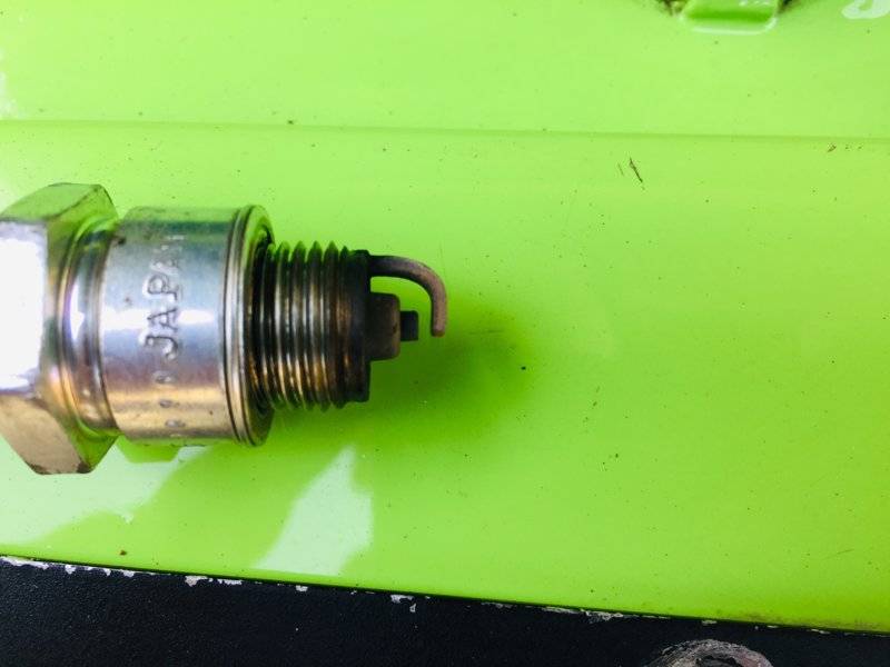

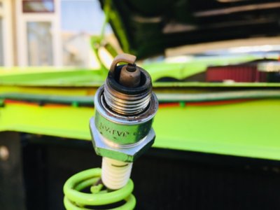

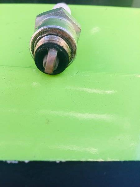

Hi fellow Mopar fans,
I have done some work on my 440 engine over the winter and all is just back together and i have been doing some test driving.
I am busy with setting up the carb and ignition for a happy medium, today i decided after done some miles to check the spark plugs.
The electrode and ground strap are clean and grey/light brown, only the base is a bit black from deposits.
The ground strap discoloration seems near the base, to me indicating too much timing right?
There is a very small line near the tip of the ground strap which should indicate a reasonable idle timing according me.
Any tips/suggestions from anyone how this spark plug looks?
Edit: Worth nothing the spark plugs are NGK XR5.
Insulator should be all tan.
This is just my opinion. Seems to me you have it running right now. Some more miles and they will clean up on their own, or you can clean, re-gap, and reinstall, then relax and enjoy the car. If you are still not satisfied, replace the plugs and enjoy as I said above. If you go looking for trouble you can always find something. A lot of us here are so **** about our cars that we see things that may or may not be there. I am inclined to do the same, I guess it's contagious.

I tend to agree with you. You may have too much timing, or too fast of an advance curve. The black spots might indicate detonation. I'm still trying to learn how to read spark plugs so it's very possible I am wrong.
You haven't mentioned what the engine is internally. Cam, compression, heads, type ignition, etc. I always start with the FSM and work from there when tuning. Gap on plugs was 35 in the day and it still works for me.
The pics don't show super good on my phone, but from what I see, those plugs are too cold. Yes too much timing. Idle is rich, and it could be shadowing playing tricks on my eyes but it looks pig rich towards the mid range. Cut the threads off so you can get a good clear view of the insulator all the way to the bottom. You're doing it right, keep tuning and keep checking!

I would think you'd be real close at a '5' NGK heat range, so like I said maybe I'm just not able to see thread coloring from my end.
The first threads are a little colored, not black but more a dark gold tan from heat.

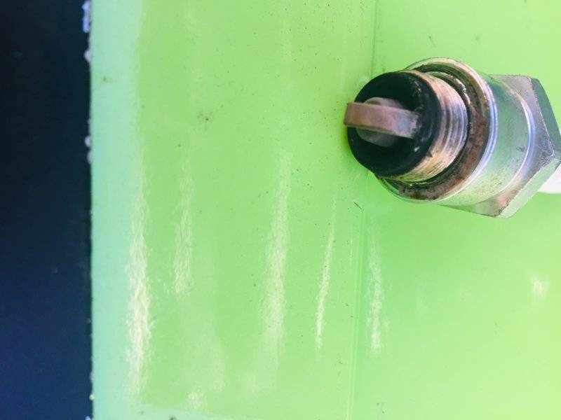

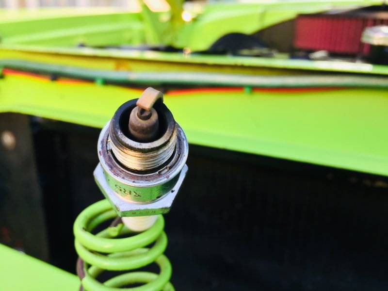

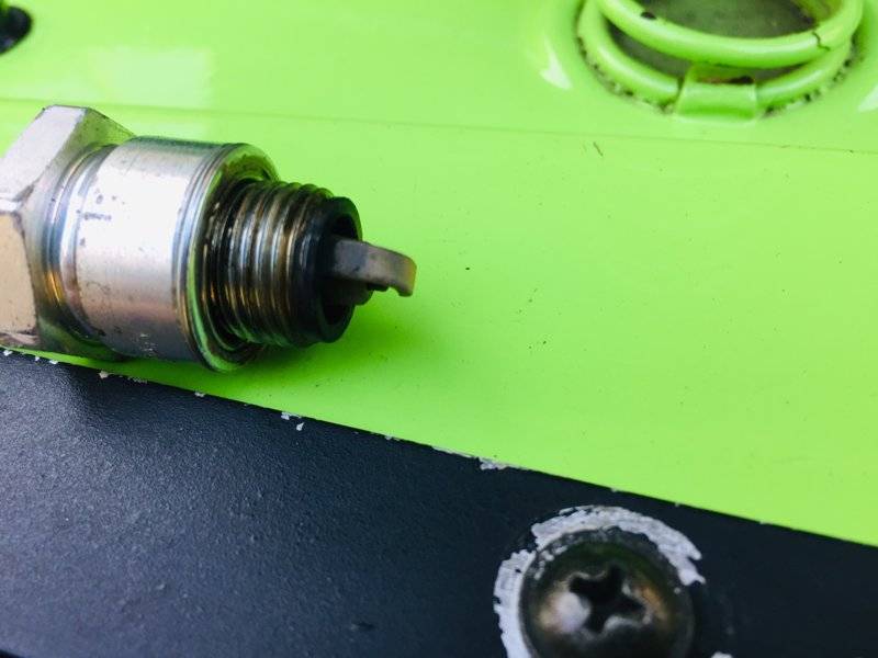

I had cleaned a spark plug and stuck it back in, this is what i found after some miles.
Think it looks better.
