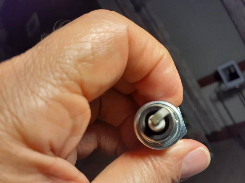

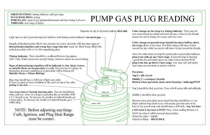

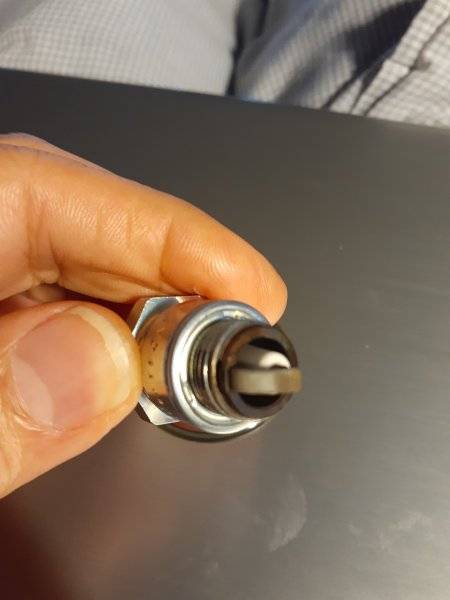

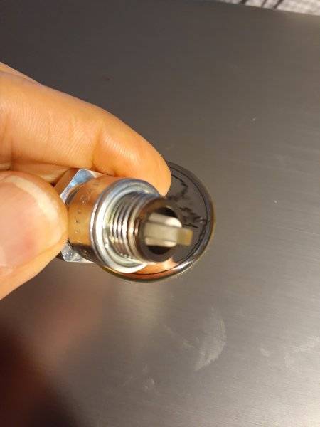

they say the ground strap darker burn should be closer to the bend. so is mine to cold of a plug because it's toward the tip ? 440 9.5 compression xr5 ngk plugs.

the top chart says heat range the bottom chart says timing for the ground strap so what is it ? the more i read the more confused i am

NGK 5 is the correct heat range, unless WOT road racing. Plugs looks great, plenty would want to swap with you.....
