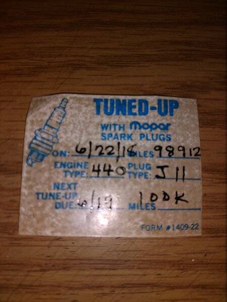

Sure. They're all I use.
Ut oh. Looks like I'm overdue for a set. :)
