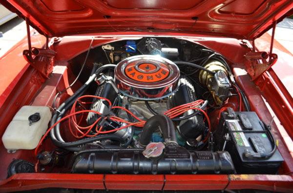

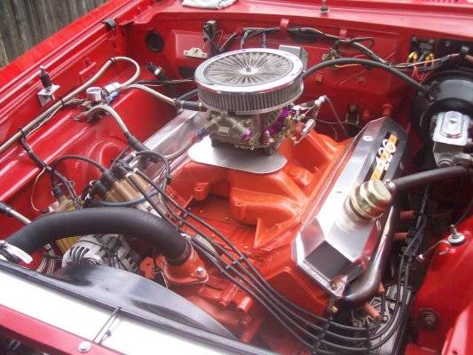

The only manufacturer for ignition wires that I know of ( who make wires like OEM but 5X better) is Firecore. You'll have to call them to see if they stock your exact set or send an old set in and have them made to length just as original. They're not cheap but good things usually aren't. I saw the pic of your engine bay and I think it could use a bit of tidying as far as ignition wires go. If you're sticking with the rocker covers you have, I highly recommend MSD's standoff's that can use the existing cover bolts holes but you'll have to get longer ones. I use 1/4 - 20 black Allen bolts on mine and "stack and wrap" them around the front of the exact same covers.
I certainly agree with Yatzee, Firecore. But don't send your old ones. Get a set made for your car/engine that route the way they should. You'll be glad you did.

These are Firecore plug wires on the 440/493 in my 63 Sport Fury. Been on my car since about 2011 and still work like new and fit great. Ron
