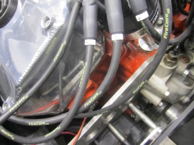

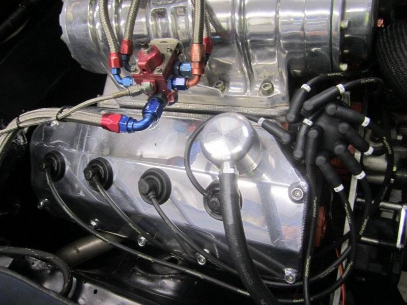

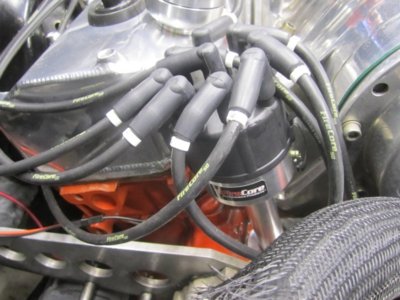

Firecore products are the best I have ever used and should fit your needs!! Call Rick.
