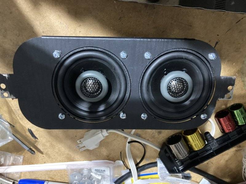

i made a speaker bracket that allows 2 speaker in dash. i have 10 left if interested. $30 shipped. just another option.

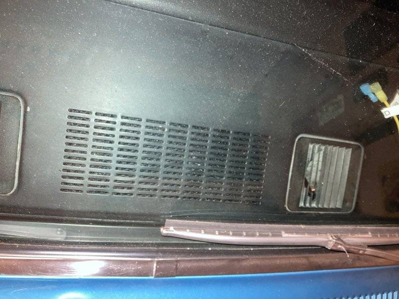

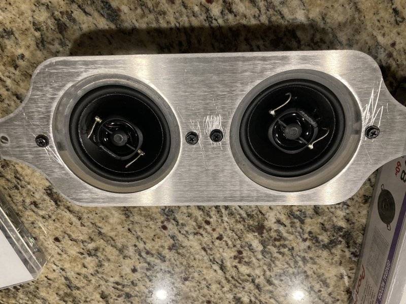

I can't remember where I got the first bracket, but I installed some Pioneers into it for my front speaker. But I could not get the heater controls (non A/C) to work/fit. So I found a guy on eBay who made mounting plates with speakers for e-bodies and he swore it would fit and clear my 70 RR. It almost cleared and I redrilled some holes, but eventually it all fit. I did this with my heater box out and controls installed. So not sure of ease of install with heater box in for the front speakers. I put 6x9 Pioneers in back with an Alpine unit, no amp required like older stereos, I guess. Just wanted something similar to my setup in the 70s/80s. In back, I mounted the right one at an angle in the defrost opening and the left side I used an adapter plate for the smaller hole. I mounted them from underneath and they are covered by the package tray with slots -- works fine. The original stereo will go with the car if I ever sell it and I saved the original front speaker. I love the fact that I can plug in a USB stick and listen to music.

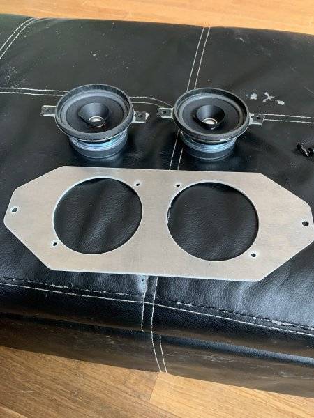

This did not fit...
This cleared the heater cable...
Put some grill cloth on top similar to factory before I mounted, and it looks fine...
mine fit perfect. no mods required
