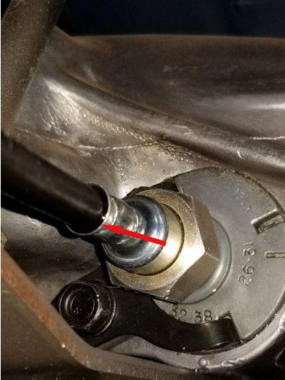

As shown in pic, leaks between metal housing at end of cable and cable. Everything else seems dry. Is this an inner seal issue?
Yes it is, there should be no fluid inside the cable. Odd that it doesn’t come out anyplace else.

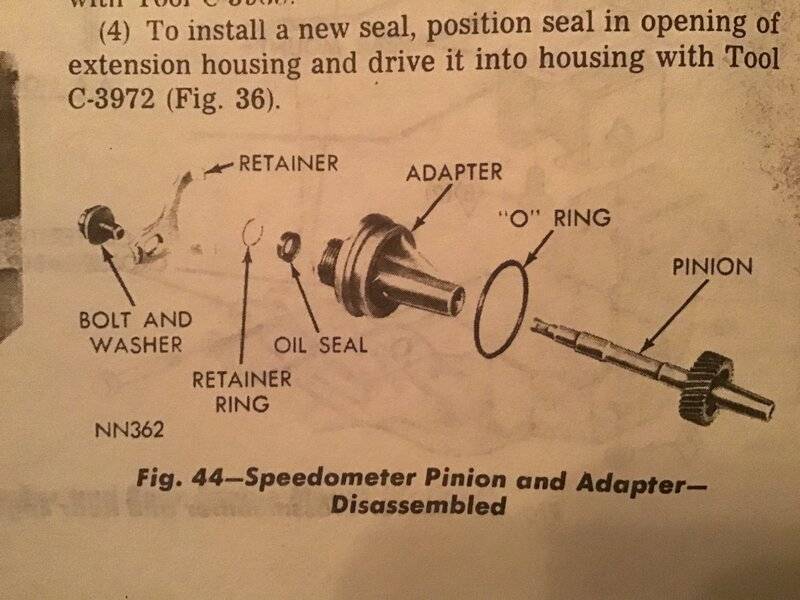

unscrew your speedo cable, pull it off. You need to unbolt the speedo adapter from the transmission and remove the gear. You will see a small clip and o ring on the cable side. The O ring needs to be replaced to stop your leak
It is a seal ring below the clip inside the bore. The outside of the housing has an o ring.
Edit service manual photo added. It’s not an o ring it is a seal. I’ve changed hundreds them.

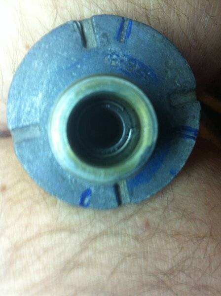

here is a old housing showing the clip and O ring
Make sure the lip faces in when installing!
