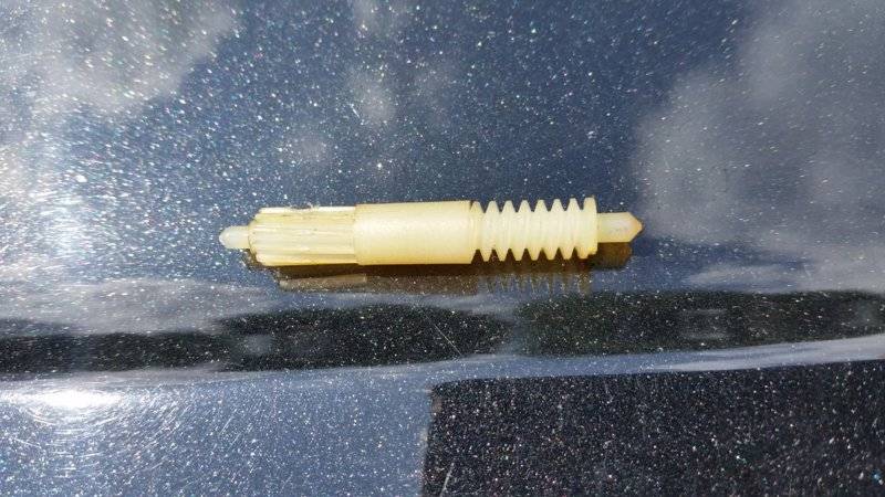

I had the exact problem. There is a white plastic gear that runs off the speedo to work the odometer. They strip. I'll post a picture of the gear. Tricky to disassemble as they peen a washer into the housing. If you remove it the speedo will function smoothly again. Just no odometer. I ended up buying a speedo from a forum member, set the mileage to match the old speedo.
