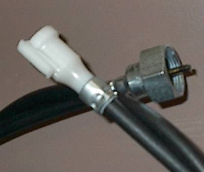

Could someone please share the steps required to disconnect the speedometer cable on the back of the speedometer. I have a rally dash. Does the dash cluster need to come out? The replacement cable has a white plastic end. Thank you in advance.

It is crowded in there under the dash but it can be done without removing anything. Patience is the key.
Should be just a release tab that gets pressed down to remove it from the speedometer.

The last time I installed a new (repro?) speedo cable I just tried to push it on (without having pressed down on the locking tab to open the little tooth catch). In doing so, the little catch/lever snapped right off!
