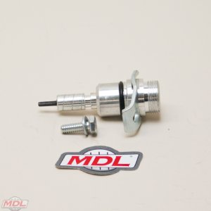

Thanks for the ideas. I am in no hurry to fix it as I have 15 years into it now so why hurry. [lol]. What I did find is this adapter that will allow the gear and clip I already have fit into the transmission. Then I will just pony up and buy a new Mopar cable. That way I wont have to ever deal with this half breed cable they sent with the transmission conversion kit.
