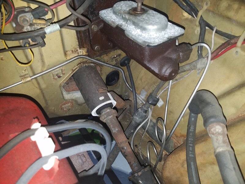

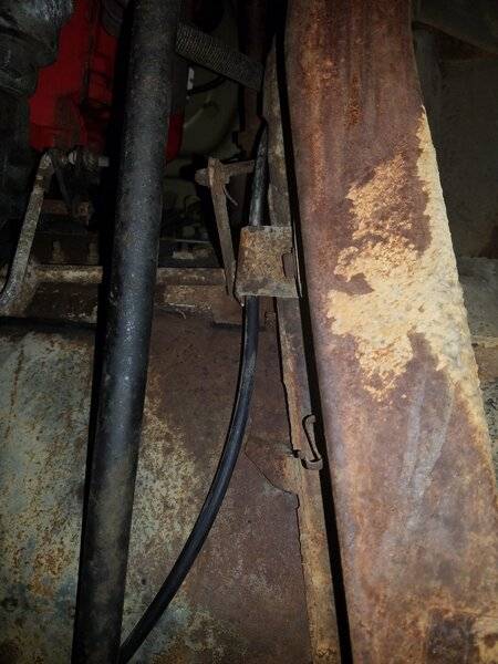

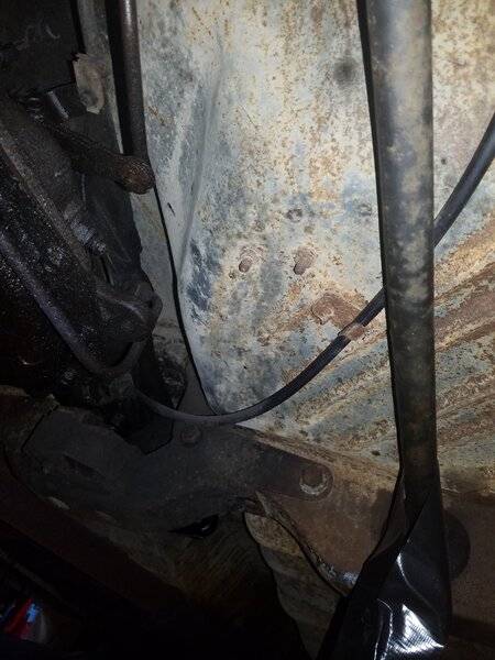

Speedo cable routing on my 67 Belv:
Out the firewall, loops down under car along inside of framerail, over torsion bar, I to trans. There are 2 clips that hold it in position.
