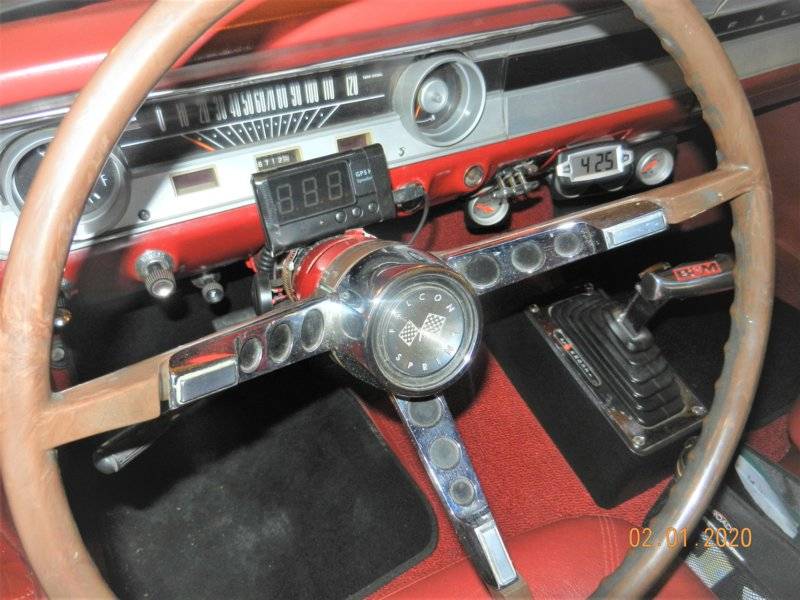

-- I had issues with My speedometer accuracy - got tired of it, and added a GPS Speedometer, from AMAZON - about $28. and it' works great. -- ( It's not a Mopar)

OH, love the Falcon Sprint. My High School Buddy had a 64 Falcon Sprint with 289. It was a cool car. Precursor to the little Stang. B.

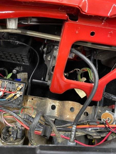

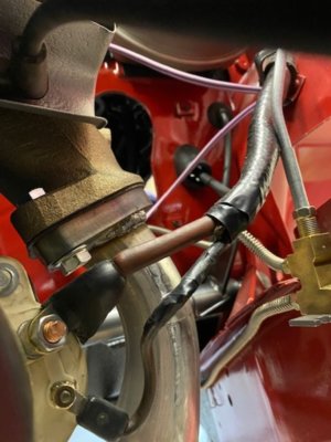

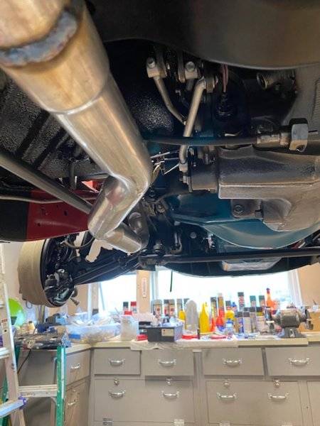

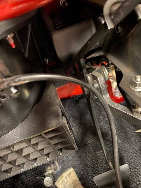

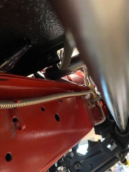

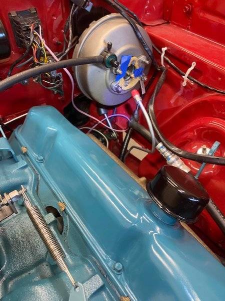

Ok, so here is the routing that I now have from Trans to Speedo. I hope we can enlarge them so we can see them. My first attempt at loading more than one or two pics.
So, From the Trans, over the top of the Exhaust into that small clip headed towards the engine compartment. Then up between the firewall and the Z Bar of the Clutch and into the FireWall. From the Fire Wall up through the half Clip and finally around through the hole behind the Speedo to the speedo. When the dash is up in place, there is a big kink in the speedo cable (I think) just behind the Speedo. As I say, it seems like there is too much Speedo Cable inside the car?? But, if that is the case, it would have to go more out into the Engine Compartment?? Where to put slack? Thanks, B.

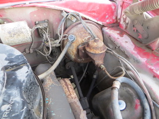

AAAAha!, I think I finally found a pic that can help me. Here is the original position from the Top Side. The pic was taken just as we pulled the car out of the barn. Notice the Speedo Wire is on the Engine Bay Side of the Clutch Z Bar. I will give that a try to see if that helps. I do not know if this can be saved to help others in case it happens to them, but here we go. You can see in the "original" shot that the Speedo Cable is on the Engine Side of the Z Bar as compared to today when it is tucked up close to the Fire Wall between the Z Bar and the fire wall. So, I have a bit of a chore ahead of me today to remove the Speedo Cable and reposition it. Then a Test. I will let you know how it goes. Best, B.
Update, I pulled the Speedo Cable from under the car, freed it from the Clutch Z Bar and ran it out to the side of the Car. Hooked up the drill and wife had a look at the Speedo while I put some speed to the Speedo Cable with the drill. BOOM! we got a reading on the Speedometer. What I also found is that when checking the Speedo through the cable with a drill, the drill needs to be in reverse to read on the Speedometer. So, I am now going to re install Speedo Cable into the Trans and give that a try again. Fingers Crossed. Best B.
Final Update- Installed the Speedo Cable back in the Trans, started motor, put it in Second, let out the clutch in second gear and WOW, the speedo worked and was solid. :) And man, am I a happy camper. Now on to the next project. Thanks to all for listening and helping. Appreciate you all. B.
