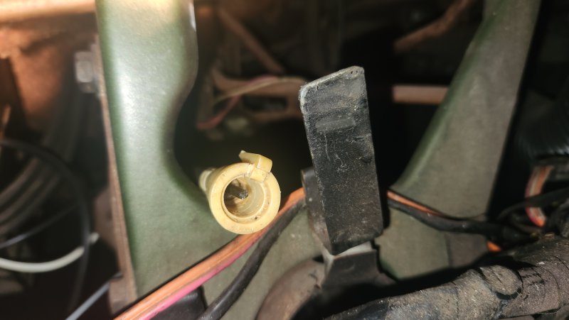

**edit. When I pulled the cluster out, the speedo cable didn't need to be pulled loose. It stayed behind. I assume it wasn't snapped on and that's probably why the speedo was spinning all over the place LOL.

Sounds like you have found all the problems. Be careful with cleaning solvent, I took off the odometer numbers on my 65 speedo with brake cleaner. Lube that cable with a light grease. A little research should find a product recommended for such use.

If you still have a problem, either the speedo cable may have gone bad or the gauge itself. Sometimes you can fix the factory cable by cleaning and relubing it. Didn't work for me, so I bought a rather expensive custom made replacement from Redline Gauge Works The Redline outer cable is vinyl, the cheap replacements are plastic and can melt.
If you replace the cable, you'll probably have to replace the firewall grommet too. I got a new one from Detroit Muscle Technology. You have to push the grommet over progressively larger sockets to get it over the speedometer cable head. With lube and a heat gun to soften the rubber, it can barely be done. Hope your hands are strong and your patience immense.
My grommet didn't shrink down tight over the cable afterwards, but it's turned out to be a nice spot to route extra wires through the firewall.

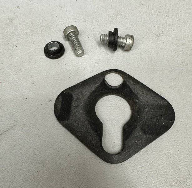

The play shown in you video is not normal. Will the screw not tighten up?

Only the screw on the right, in the vid is attached to the housing it's tight. the other screw is also tight. But if it's normal, then I'm happy. I'm gonna wipe it all down with carb cleaner, a nylon bottle brush, and some q-tips. I'll grease it up and toss back together. If the cable no longer snaps onto the cluster, then I'll order a new one.

Old thread, as for the mounting issue, you are missing the rubber grommet that should be under that screw head. Possibly the rubber pad that goes between the speedo and the cluster frame.
Been searching for this part for about a week now. No luck. Thank you for the heads up. We'll continue to search screen
