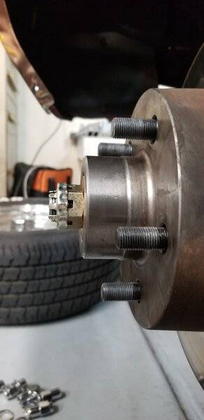

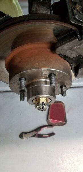

Do all spindle nuts require a retainer? I have aftermarket spindles and brakes on this car. Did about 20 years ago. I don't remember when I took this apart if there was a retainer. The castle nut is what came off for sure though. The retainer in the pic is from the local O'rileys. Is it better to get a thinner spindle nut and use a retainer or the nut I have?

Thanks for your input. I was able to find a set of spindle nuts at a local mom & pop parts store that fit these spindles (spindles are not stock) and the retainers I already had. I did install the castellated nuts just to measure the difference. Certainly can get closer to (at least in my case) spec with the standard spindle nut and retainer.
