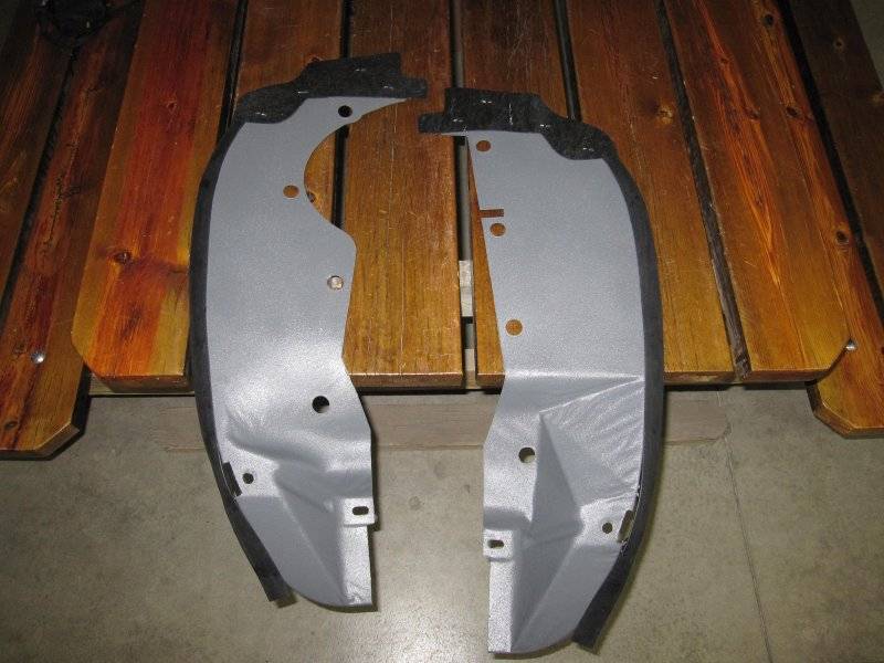

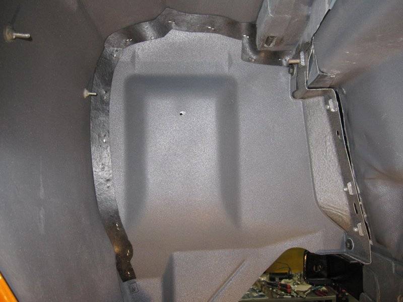

I coated mine to match the rest of the under body. 65 Belvedere.
Mike

Mike,
Great pics! Thank you. Now what the heck am I looking at here!? LOL! Are the two photos up top the two pieces below installed? Or am I way off base?
Appreciate your eply buddy, thanks.
Jeff
The top photo is the left front splash shield and the next down is the left rear. It has a notch cut in to clear the USCT inner fender brace.
Mike

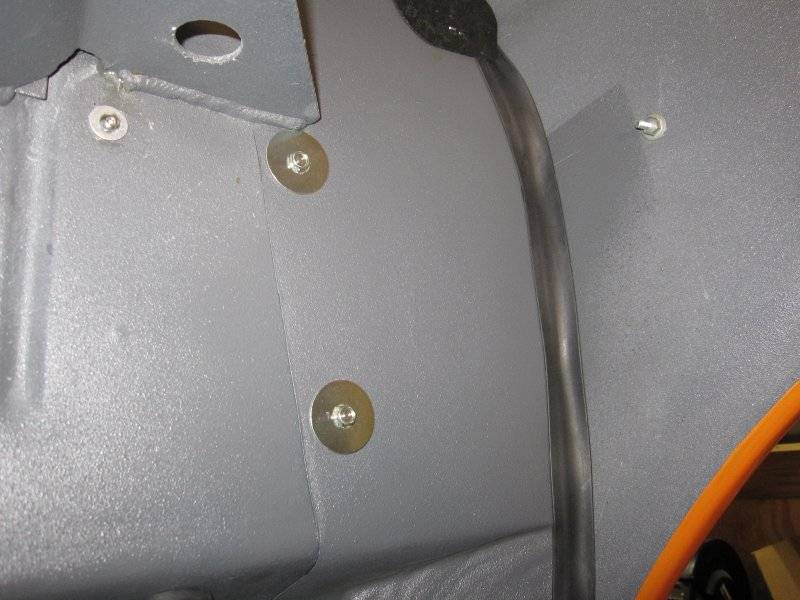

Mike,
I think I'm getting it now. LOL! How did you determine where to drill holes for the staples or was it the clips that look like staples? What size drill did you use? Looks really good sir! And how many screws/bolts with the big flat washers did you use? Do the attaching bolts for the front shields come in from the engine bay side of the front of the fender?

Mike,
Thanks again,
Jeff
The holes were OEM as are the shields. I opted for the stainless clips when I purchased new rubber seals. The screws with fender washers were also determined by Chrysler and in the screw kit I bought. In the front shield, the inner fasteners fit through the shield into the inner fender and the outers come in from the head lamp area, including one from the center-not shown in that pic.
Mike

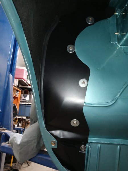

Jeff, I know this is late, but here's mine. Were you at Carlisle, the Tent ? Without the name tags, not sure who I was talking with ?
Very nice!!! Love it! Do you have photos of the front shields as well?
