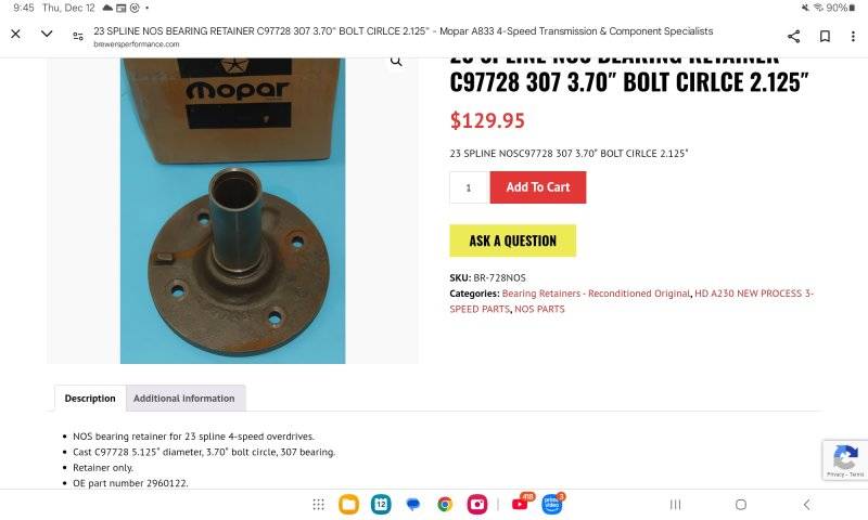

I don't know why they did it, I ask myself that question a lot about muscle era mopars. Here is a picture of a 307 bearing overdrive retainer. All that material outside of the bolt circle is doing nothing, and could be machined down to 4.80" or 4.35" to fit your bellhousing, or just replace it with a different one. Ignore the 2.125 in the heading, it is corrected in the text.!
Next time I am at the shop where my transmission is, I will check that bolt circle and see what I've got. I did e-mail Brewers to see what they've got. Do you think it's worth it to go with the billet retainers they offer vs the cast ones? Not sure if that would help "rigid-ify" some parts considering it's an OD, or if I would be wasting my money.
