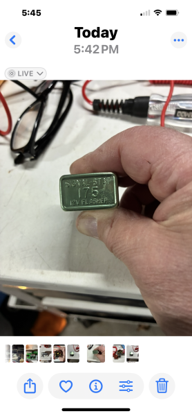

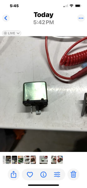

Why is my flasher square not round and I got 3 out of 4 blinkers blinking but it’s a fast blink and I don’t here the flasher clicking any ideas thanks vinny

3 out of 4 isn’t a flasher issue. Likely a bulb. Square or round is fine. Assume your checking the 4 ways and not turn signals. What does your turn signals do? All 4 or just same 3?
LOL !! I installed LED taillights. The flashers/signals weren't working. I bought 6 new relays of different types - electronic ones, ones with ground pigtails and a few more. Ended up using both originals (one round one square) but one needed the leads flipped. AND, they will only work where they're installed - they can't be swapped.
Yeah, weird !!! Good luck !
For some reason, hazzard flasher provider was different than the turnings flasher as far I know, hence why hazzards is square and turnings are round.
HOWEVER that seems to be a replacement piece, not the factory one.
As mentioned, your fail is not related to flashers. Could be switch or bulb.. or ground related to the missed side.
On a side note, which corner doesn’t blink with hazzards? Does work with tunings?
