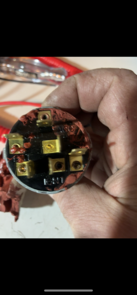

I can’t believe someone can rig this like they did some one spliced into the harness but connected wire and then hooked it up to the ignition switch then filed the back with silicone then taped it up they never hooked up the ground that comes from the back of the switch so when I undid there mess I could see what color wire went where can someone please tell me the colors from the harness and where they go on the switch oh yeah it for a 67 Coronet R/T
Thanks Vinny

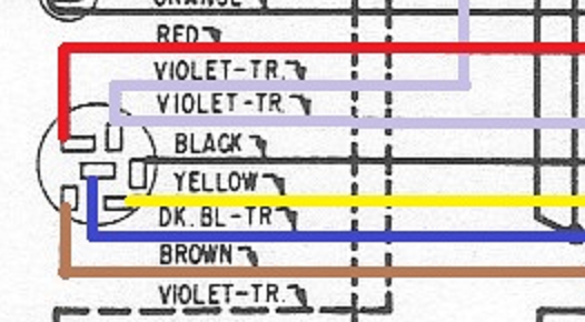

Yellow wire from switch goes to starter relay on the firewall.
Brown wire goes to the ballast resistor on the passenger side firewall
Red is main power
The violet colored wires are both on one connector that feed the water temp sender. The other wire that comes off goes to the brake warning light.
Go to the link in the above post and download the wiring diagrams for 1967. CoronetA and CoronetB are the 2 you need but each year downloads all of that years makes. Or this is a direct link to the 1967 download. https://www.mymopar.com/downloads/wiringdiagrams/1967Wiring.zip

The ignition looks new it’s the wires they spliced from the harness to the ignition switch that I need to now the colors and we’re in the switch they go

What color goes to BAT and what color goes to GRN and what color goes to ACC and what color goes to IGN 2 and what color goes to IGN 1 and what color goes to ST that the information I need is what colors go to the back of the switch

Following diagram, the violet signal is a ground signal for a light test to the brake failure warning light on cluster. An splice into the brake fluid dist block switch wiring warning you if floats on a pressure fail (leak) to the brake system. I guess a light test while cranking.
Nothing to do with temp network, which is a gauge, not a light.

On a side note, the ground for the cluster brake light test is taken from chassis, not wired. Ign switch doesn’t require a ground to work.
Red, batt/alt input
Blue, ign1 (run stage)
Brown, Ign2 (start stage… ballast bypass)
Black, Acc (run stage)
Yellow, starter relay (start stage)
Violet, ground for brake cluster light circuit test (should work on start stage)

Ok I hooked the ignition switch back up like you described but I noticed that there is no violet color wire to hook up to the ground originally when I took the silicone off from around switch, the ground wire was not hooked up. I searched the wiring harness where the ignition wires come out of, and there is no violet wire anywhere to be found. That’s probably why they never hooked up the wire coming from the ground in the back of the ignition. Can this be why my dash lights and my gauges and things like that don’t work
As mentioned, there is no ground to ignition switches. Is taken from chassis when required just for this purpose.
Tipically the brake warning cluster light test is a C body feature. Hence why I found weird this feature on a diff body (Coronet on this case). Hence I don’t trust on Mymopar diagrams. It works as a guide but they are tipically not 100% correct.
On the rest of bodies, the cluster brake light is a signal warning you the emergency brake is applied, or also the brake fluid pressure failure when riding (once emergency brake is released). On these, the test must be made manually. On engine bay uses to be a female packard terminal attached to the line to jump out a ground signal into the wiring to proceed with the cluster light test.
These is at least for later models. Maybe earliers could be a bit different, since several features were being added along the years as standard, being optional on their first appearance.
