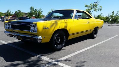

Need some help. Just had a Hellwig front sway bar installed and brand new bfg radial TA's on police wheels up front. 68 Satellite. Now when I take a turn 5 to 10 miles an hour I have what sounds like the front tires squealing. Not sure what is going on here and thought I would reach out. Also over bumps the car seems to skip to the right or left. Any insight is appreciated. It didn't do any of this prior to the new wheels and sway bar.
